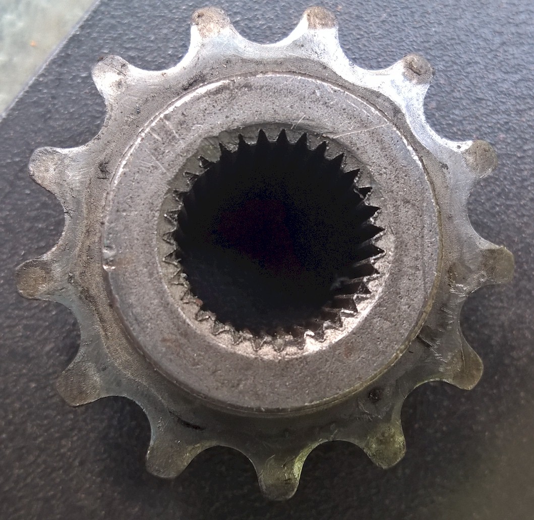

Did you check the part numbers on the starter sprocket. I seem to recall someone else having this issue on a Kz400 and it was the starter sprocket was the wrong one. I took this photo for that thread. It's from a 76 500D3 . It has 13 teeth and 31 splines..

I received a starter sprocket with the new chain, and they were identical - 13 teeth, same number of splines..
