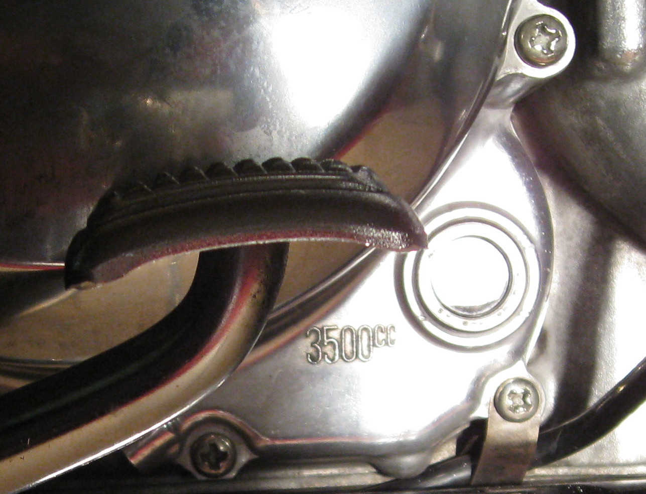

I don't understand. You say you stopped at 2.5 quarts. Why? My KZ650 takes 3500cc of oil, and that figure is clearly marked at the oil level window (see image below). 3500cc = 3.7 quarts. Does your KZ750 have a similar mark near the window? So assuming your KZ750 holds about the same amount of oil it is not surprising that it would be underfilled if you only put in 2.5 quarts. Ed
Last edit: 06 Oct 2020 16:59 by 650ed.
