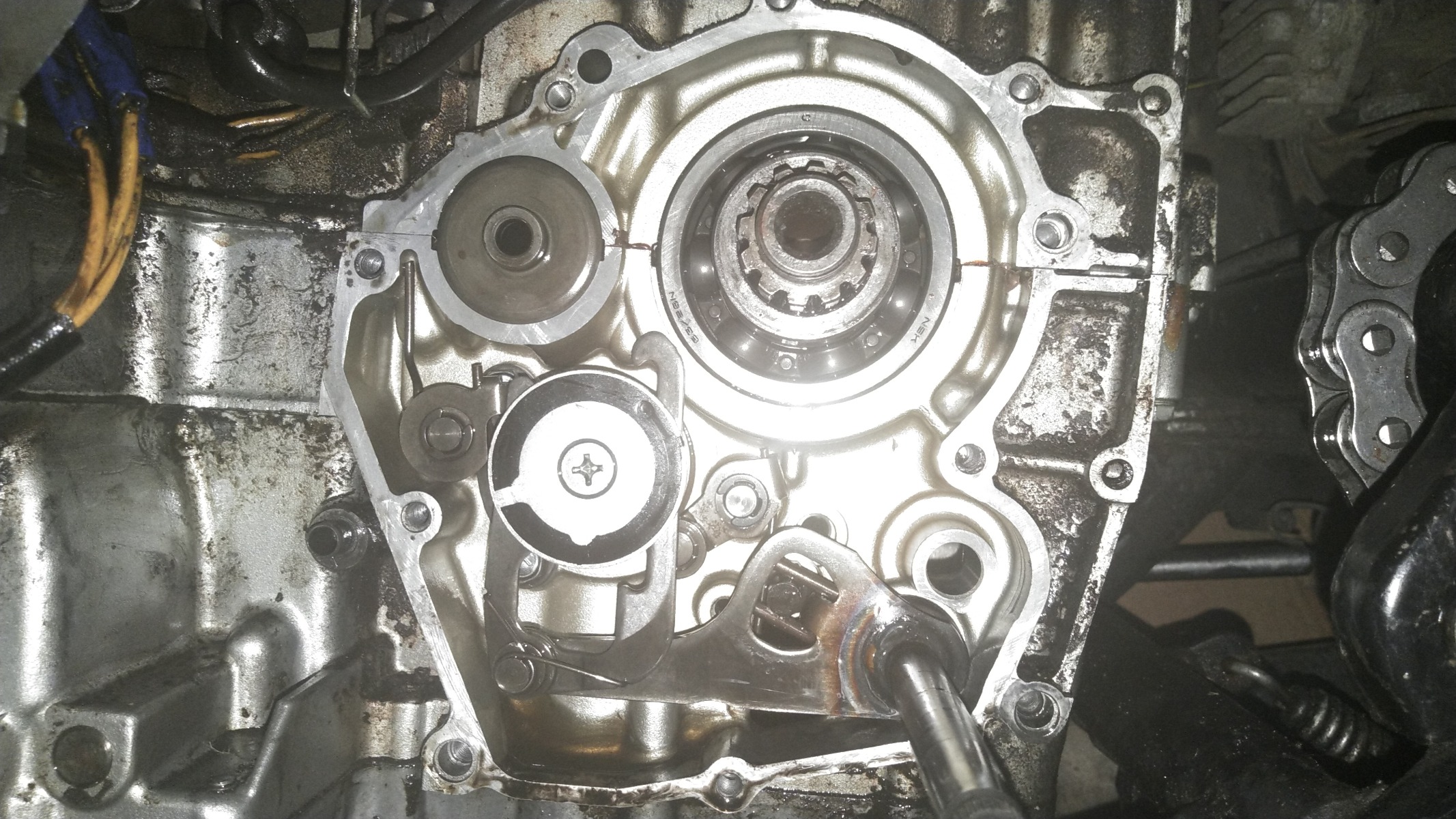

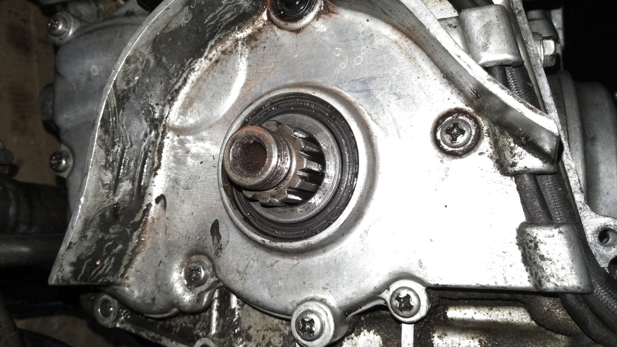

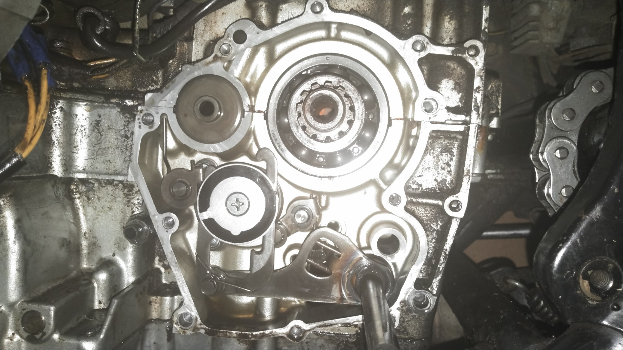

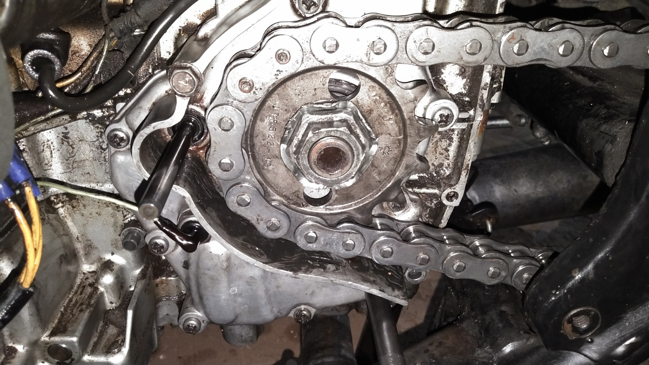

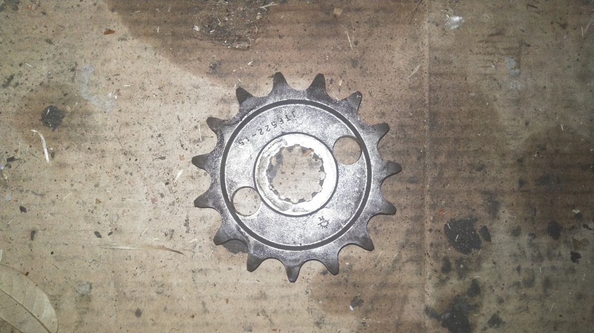

Took the sprocket and associated cover off. Again everything looked normal. The push rod does rub something when about 1.5" before being all the way inserted, more of a sound than an obstruction. I took some pictures so you could see if there is something that I have just been blind to.

Not a good view of the sprocket splines. Not rounded off, parts of the inner splines ground off, metal particles anywhere, fits tight when you slide it on the output shaft?
Is the rod long enough to reach the bucket? I know some J engines used two piece rods., so you could only pull half of it out the left side.

There is no unusual wear that I can see. There is no back and forth movement once its on the shaft. I thought it may be chain tension, but that looked good prior to me removing the front sprocket (Etc.)
Push rod is long enough to reach the bucket. I have made sure that its not catching on the lip in the clutch mechanism, which would prevent it from sitting all the way.
Went back and verified spring torque on the clutch plate.
Gonna clean the grease off the bearings and clutch mechanism prior to buttoning it back up. Maybe it's not completely resetting after pulling the clutch to start?

Good one. Maybe with both covers off do a process of elimination. With pressure plate off put a breaker bar on the big nut while, in first gear, and holding the rear wheel. See if you can apply decent torque without turning once all the slack is taken up. This should tell you that everything between the bucket and rear wheel is good. Then with pressure plate on, wedge a prybar or something (safely) in the teeth of the outer bucket gear, and see if a helper can turn the sprocket nut with another ratchet. If so, the slip is in the clutch itself, and not the release mechanism or any part of the transmission.
I'm giving you everything I can think of without being there.
