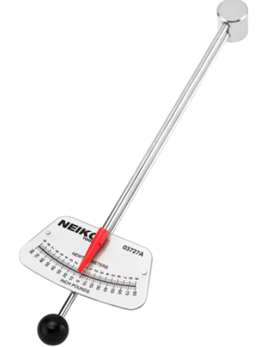

19 Sep 2020 09:33Mc Tavish wrote: Hi Nathanb, if you are using one of these throw it in the bin. NOW!
Actually I have been schooled here on this forum that a beam style torque wrench is a very important tool to have. Its biggest advantage is used when installing torque to yield bolts. That style wrench lets you see when the torque value has stopped climbing and the bolt is slightly still rotating, That's when you know to stop as you have reached the yield value.

Hi Mikaw, This will be my last post regarding the merits of torque wrenches.
I stand by my comment about throwing that style of wrench in the bin, utterly useless!
They also have no place or use during the installation of TTY bolts.
TTY bolts are set to a prescribed torque value and finished with a degree wheel.

A beam-type torque wrench got my old Metro's engine back together and running for the 30k miles until I sold it...but I'm not trying to start a debate here :whistle:
