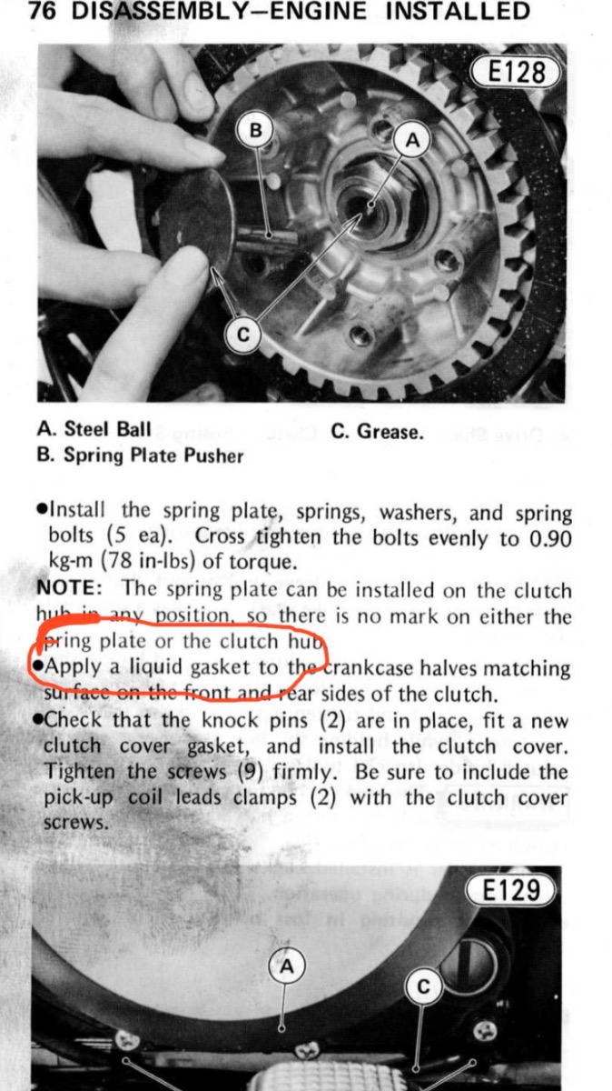

When I install the clutch cover and using the gasket, shall I also use liquid gasket, service manual say so? Three bond gasket?

No. The instruction you circled is for putting the two halves of the crankcase together. The entire instruction makes it clear that liquid gasket (3 Bond or equivalent) should be applied to the front and rear of the crankcase surface at the clutch.
Once the crankcase is together you only need to install the standard gasket on the clutch cover.
