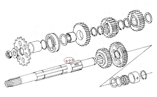

These are the 3 little balls that prevent shifting into higher gears with the rear wheel standing still. Ed

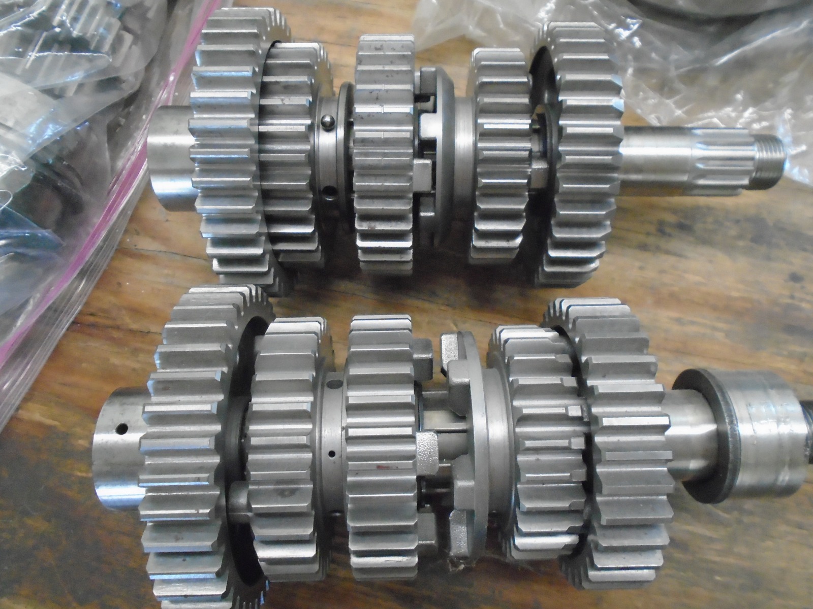

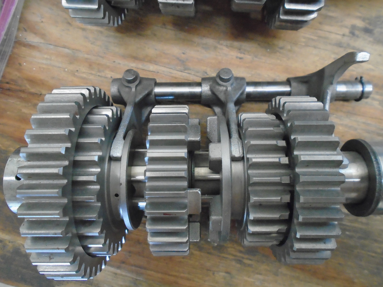

Some photos to help make it make sense. Yes the output shaft has to be spinning to throw the little (3) loose ball bearings out allow the gear to slide.
