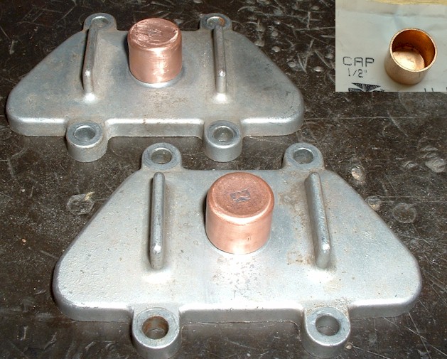

Rubber vacuum caps eventually split easily.
You can use 1/2" copper pipe caps. You have to heat them near red hot and quickly hold them in place and press them on.
We did a few that came out nice, but it's easier with two people. It might help to put the covers in the freezer first.
The copper will be discolored on the surface, but a little touch up with 500 grit cleans them like new. (Of course you can then paint them black.)
