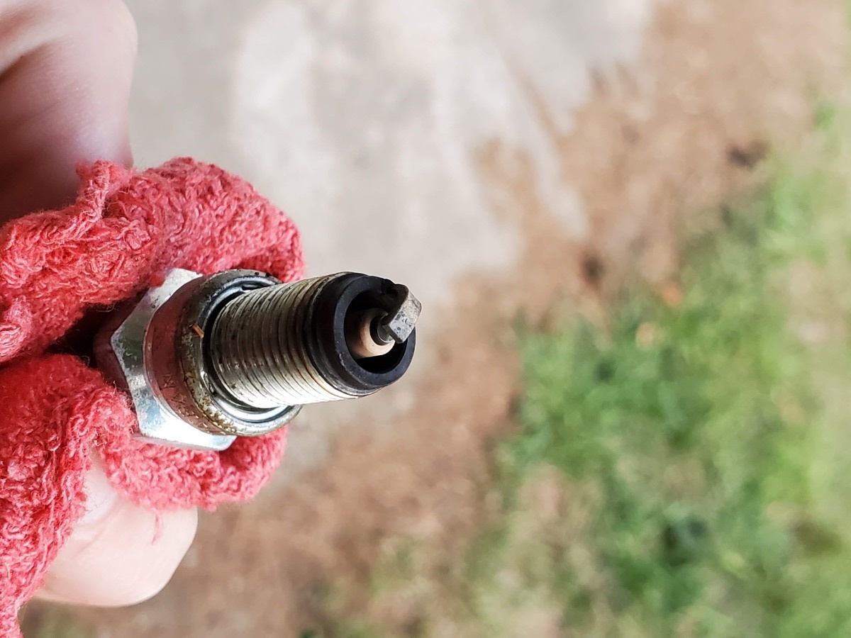

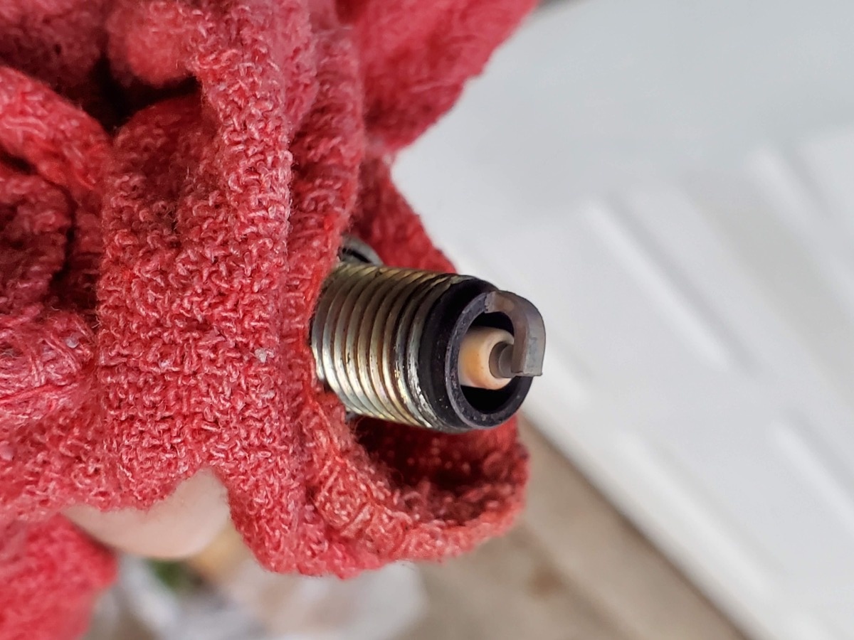

I'm still a little confused why the engine feels hotter on one side compared to the other.
Valve lash is perfect, float heights are perfect, no air leaks, etc... I double checked the compression on a warm engine and it read 150-155 psi on all cylinders.
These are my spark plugs:
This is from cylinder 1
This is from cylinder 4
They both seem to be in ok to lean condition, but that they don't look exceptionally different makes me more confused why one side of the engine is hotter (cylinder 1 & 2 side) than the other.
