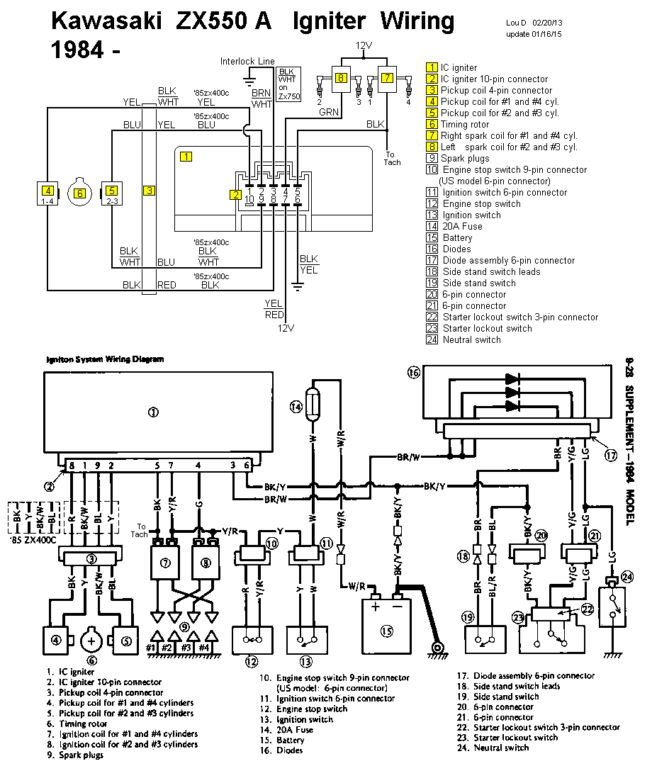

Does it act the same way with the kickstand up or down? There is a safety circuit that relies on the neutral switch to let the ignition work in neutral, and a kickstand switch when the kickstand is up while in gear (out of neutral). A flakey kickstand switch might kill the motor when it's put into gear, but vibration might let it run intermittently with coughing etc.
You can bypass the safety system by grounding the brown/white wire on the igniter.

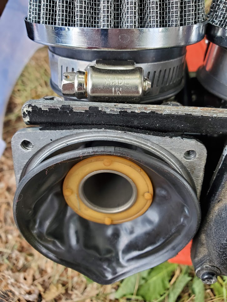

I tried checking my float levels, but it seemed gas kept leaking out of the screw area so I wasn't able to get a good measurement. I checked all of the float bowl screws and the little rubber gasket on each screw was all chewed up. Could that cause any problems? The bowls don't leak gas or anything.
In float bowl for cylinder 2, I did find some jellied-gas. The bike had been sitting with old gas for a while, so this is not totally surprising. I had filled the tank up with fresh gas, but I had not drained the old gas. Would fuel stabilizer dissolve any jelly in the tank? I didn't find any jellied-gas in any other carbs and I sprayed the jet passages clean with cleaner and compressed air. I think this definitely could be contributing to the issue.
The diaphragms looked free of tears except for on cylinder 4. The very outside edge of the diaphragm is cracking:
I don't think this a particularly big deal, but I'd like your opinions!
