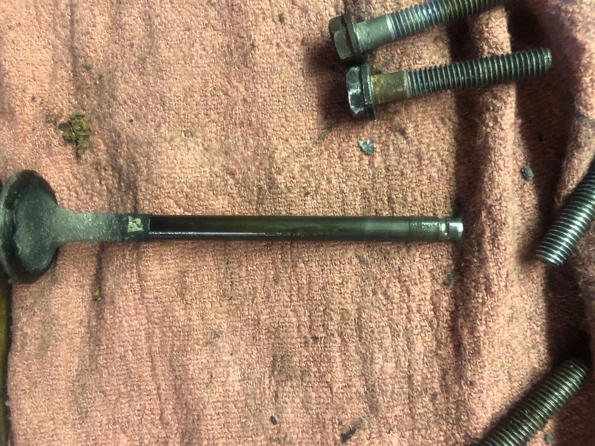

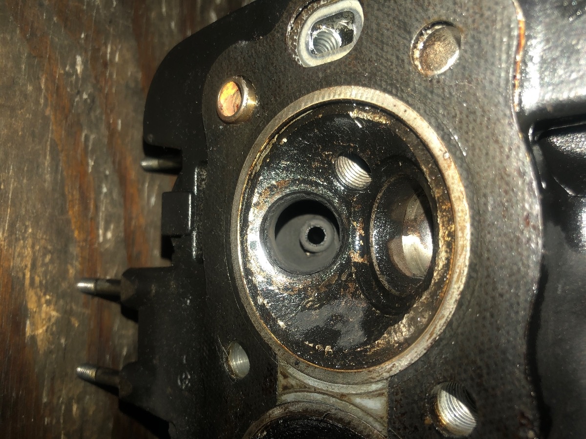

Update: took the head off and surprise, damage to cylinder 1 combustion chamber and bent valves. Now to locate news valves and sent the head to my local mechanic to have him fix the damage. Great.

10 Aug 2020 15:09 - 10 Aug 2020 15:11Aw, that sucks. Sorry to hear that. I think the valve part number is the same as standard Kz's so there should be some easily available. I'd look at any valve from Kz550 A2 to A3, C2 to C4, and D's. I think the 1980 model, (first year in the U.S.) had different part numbers for the valves than the D model, but may still be swappable. It hasn't been confirmed that I'm aware of.

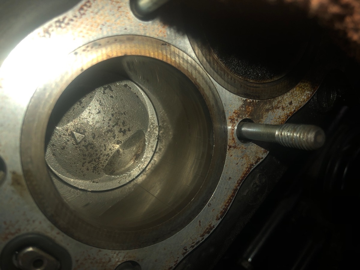

So more updating: decided to clean the carbon buildup on the top of pistons and noticed these gouges + what looks to be scratches..might have to hone it..? What do you guys think? 615 kit if it’s that bad?? This is getting worse and worse by the second!
