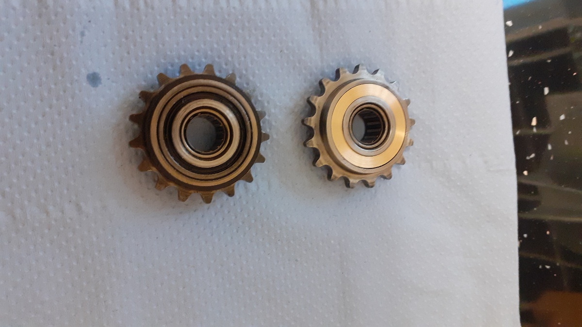

I have a few top idlers about and the rubber on and in them has gone very hard and is breaking up which is probably also happening inside the motor as well, the previous owner replaced the ones in the lower end around ten years ago but not the top, Zed1015 made some a few years ago, so i thought i would have a go myself, so today i deconstructed an old one and made up a brass ring to go where the rubber went, i am happy with the result even though it's around 15 grams heavier, will put it in during the winter if i have not made a lighter one by then.

One less roast spud at christmas dinner Kev and your back even weight wise. Good work by the way!
