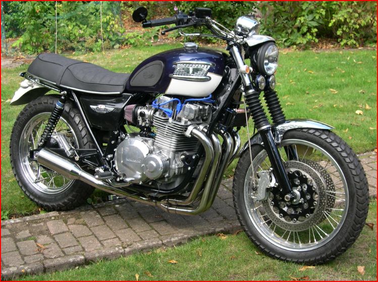

Below is a picture of a KZ1000 engine bumped ALL the way up to 1400cc and installed in a KZ650 frame. All it took to do it was time and a wheelbarrow full of 100 dollar bills. So, yes, nearly any engine can be put in your frame, but at what cost and how long will it take vs getting your original engine up to snuff? Ed

That looks beefy as all hell but I dont doubt that frame work was a bear. I'm not trying to boost my power past the limits of the frame, just trying to find an accurate fit on a budget where I can learn some casual engineering versus the bottom-top end rebuild I'm doing to the original (replacement) engine.
