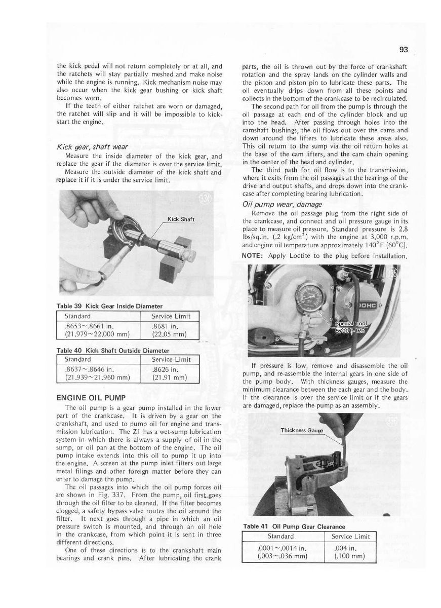

You have to check the real oil pressure with an oil pressure gauge to verify your oil pump works correct.

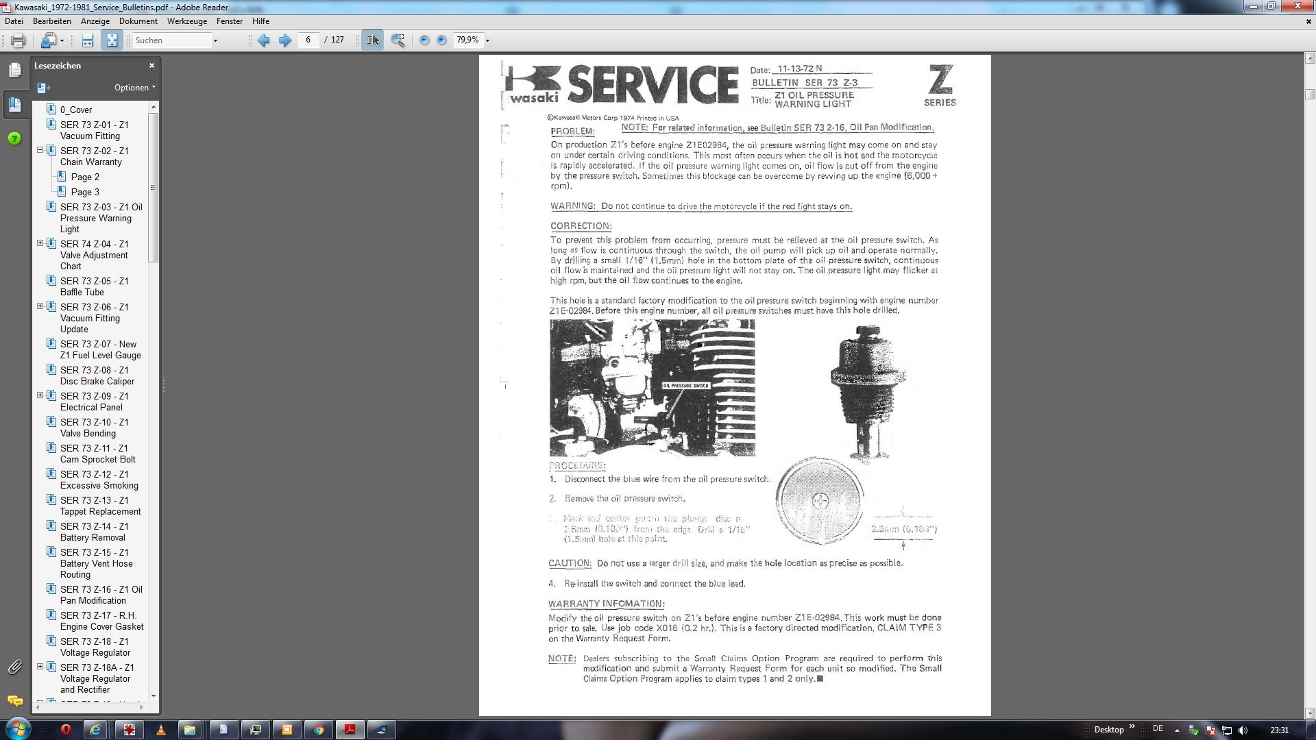

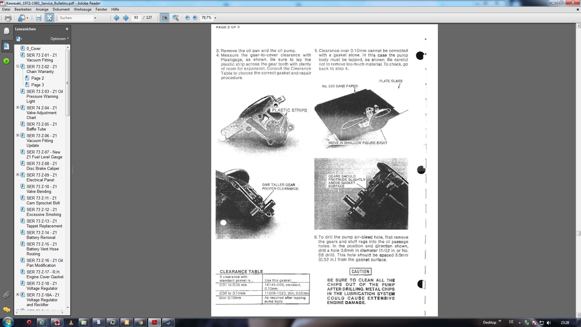

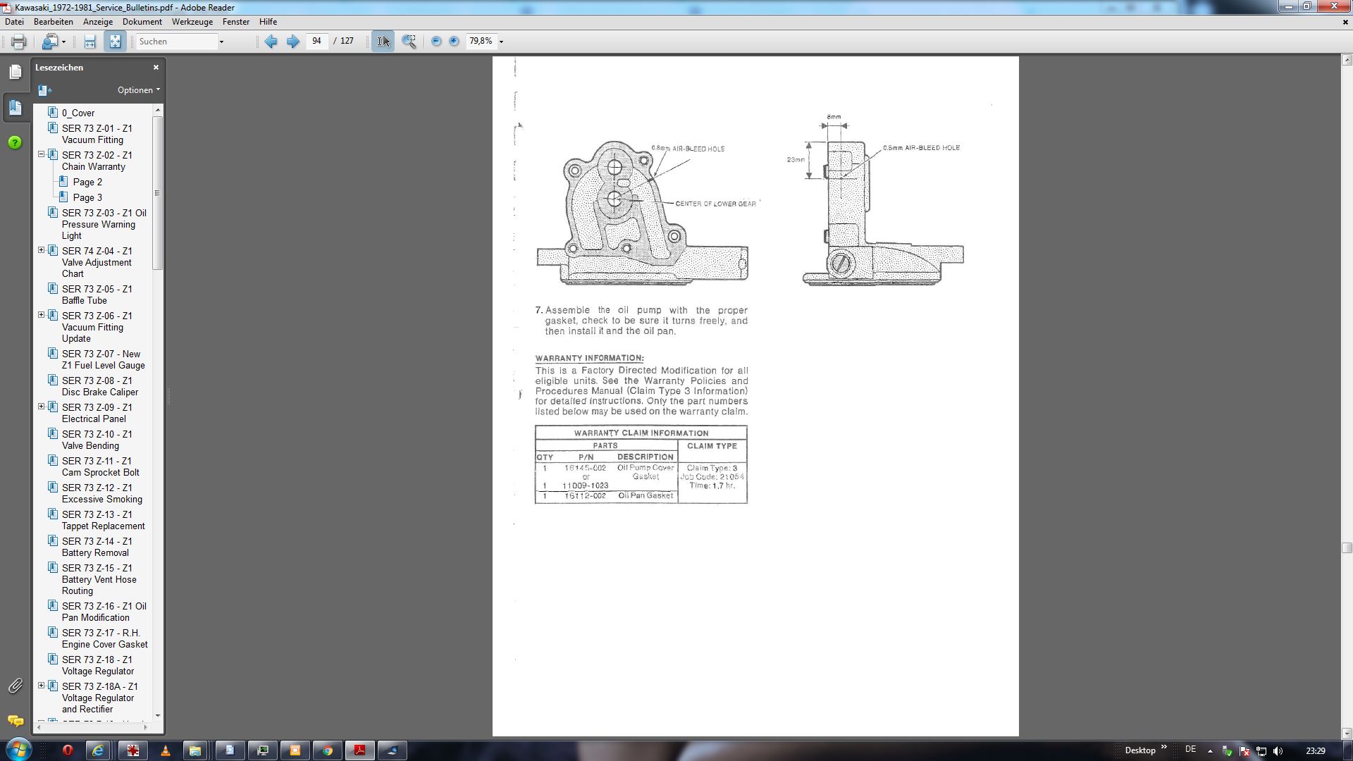

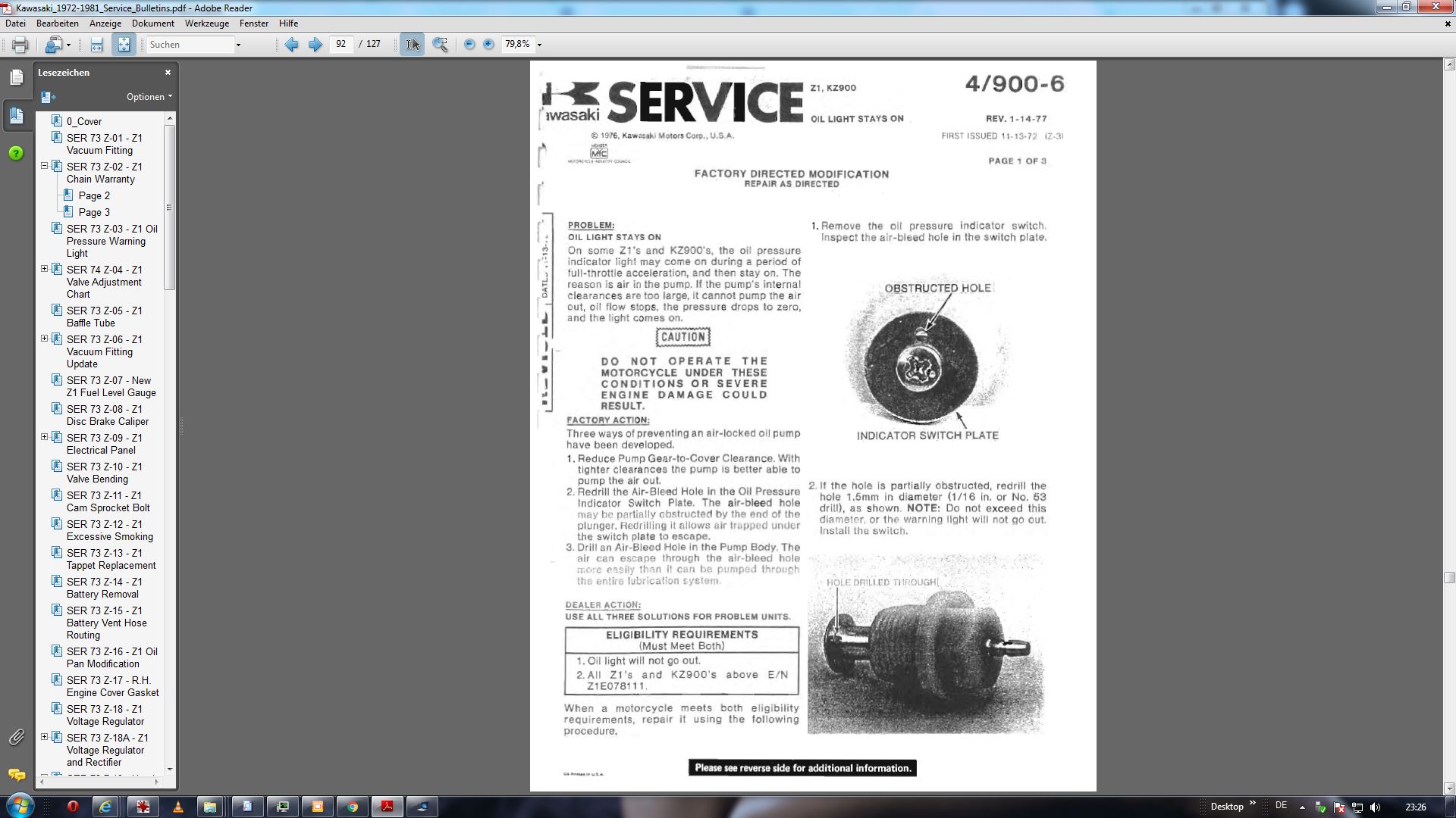

Wait for the Service Bulletins...

The following user(s) said Thank You: Flecca
Re: Oil pressure switch
12 Jul 2020 14:35
The following user(s) said Thank You: martin_csr, Flecca

Thanks for the service bulletins and information Scirocco.
I am gonna check the oilpump, i already measured the pressure with a gauge and thats ok.

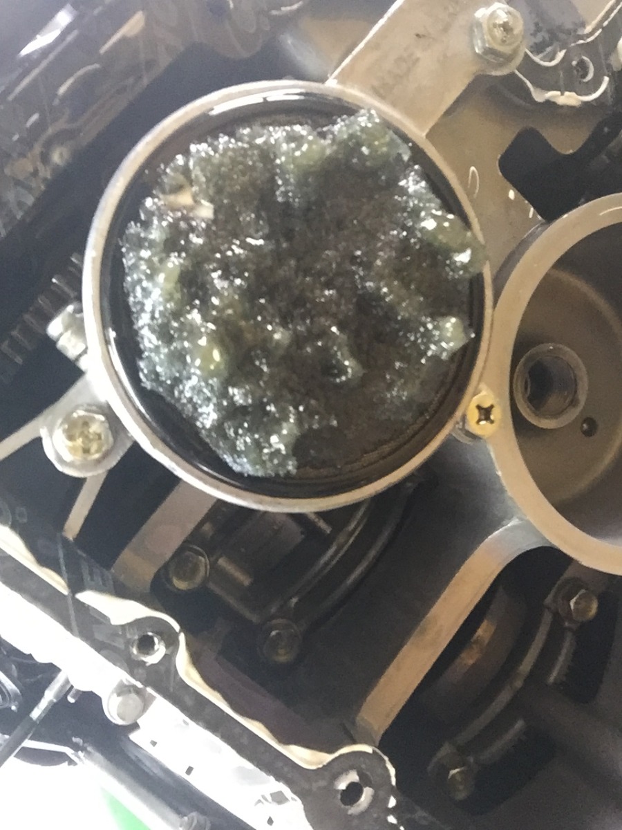

I recently had a problem with the light coming on with one of my Z1B's with a newly rebuilt engine. My first check was the switch, (because it's easy to check) which I changed out to one from my KZ1000. The light was still coming on. I thought it might be the oil pump strainer so I dropped the pan and found what you can see on the photo. Looks like a kim towel that I must have left in the engine during the rebuild. I cleaned the strainer and replaced the pan and all was good.

Wauw, thats a hell of a towel :huh: . Today a did a several hours tour and copy the situation from my last ride when the light stayed on after starting my bike with a hot engine. And now , with the new switch the light works completely normal
So i decided to wait removing the oilpan but if the problem occors again , thats my firs action.
