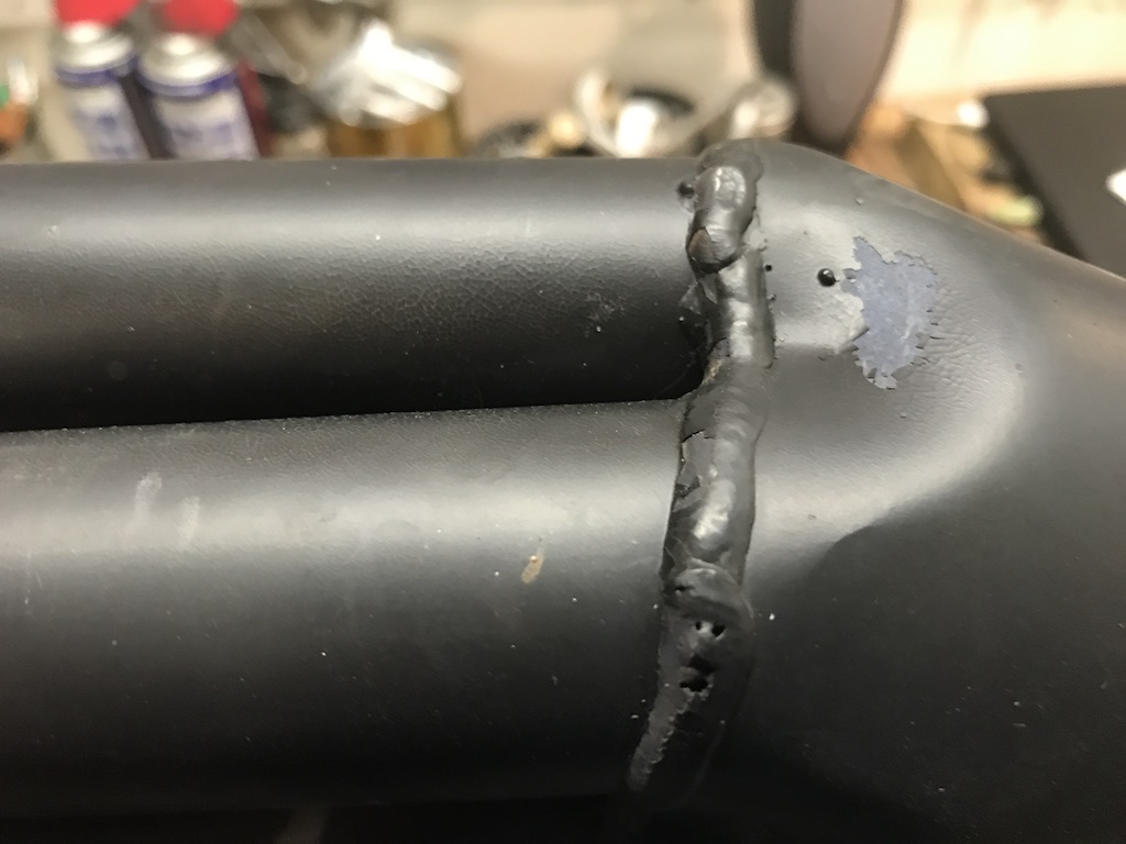

2. The welds. The welds especially the collector are of the very worst quality. You can see voids, spatter and a generally wonky bead. What you don't see in this picture is the inch of MIG wire sticking out from the weld in the confluence of the header pipes. Is that a bad thing, no, but it speaks to the lack of quality control where ever these are made. The voids in the welds are what really concerned me. I eventually cut up the exhaust and added more upsweep and had the pipe professionally re-welded.

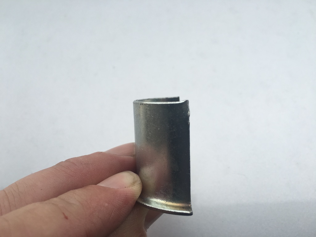

4.The little things. The exhaust spit-collars all were poorly stamped and came with "spikes" on the flat surface that compresses the header flange into the exhaust copper gasket. I didn't notice these defects at first and when I bolted the exhaust on for the first time, the spikes deformed the sealing flange to the point they wouldn't seat properly. I had bad exhaust leaks until I hammered the sealing flanges on the header flat and removed the spikes from the split-collars.
I had numerous washer provided and most were missing chunks out of them. Does that make them unusable, again no, but it speaks volumes about the quality of materials and a complete lack of quality control by Kerker. Also, the gauge of metal the system is constructed of is thin! Yes, this makes it light, but you can also dent it by staring at it too hard.

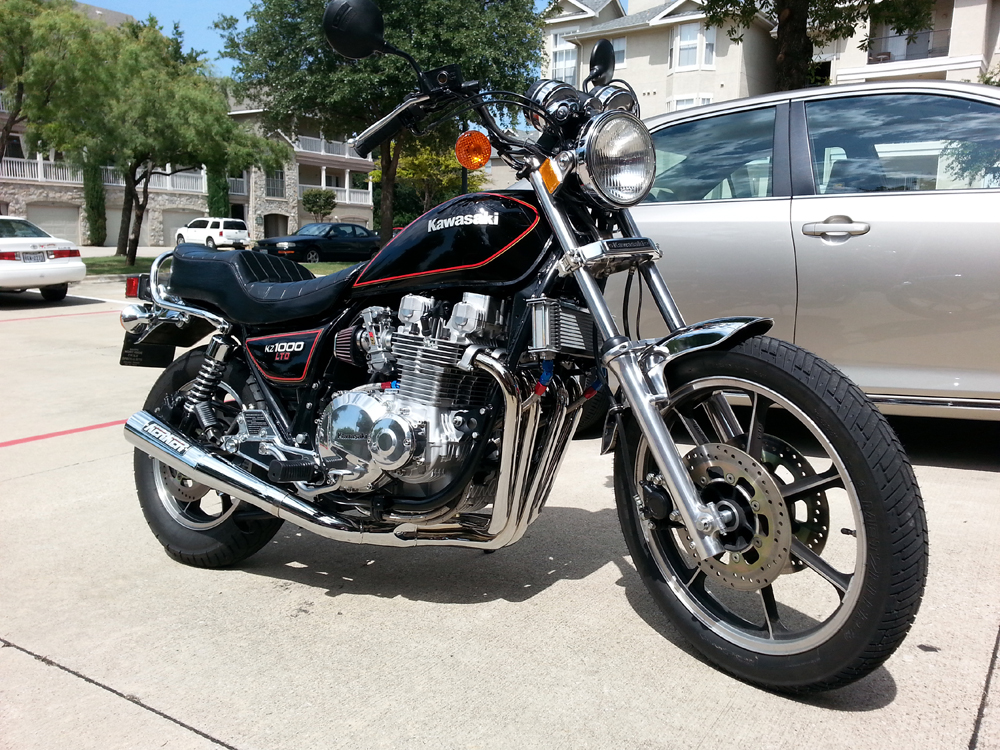

The new supertrapp KERKERs are definitely not the same as the originals. But they still look and sound awesome.
I got lucky and found a chrome KERKER for a J engine on some company's shelf in Germany. It was the last of the discontinued chrome exhausts.
The chrome blued at the head even though I painted the inside to prevent it. And the baffle loosens up from expansion and contraction. But it still looks and sounds too cool, the welds are high quality, and unlike the originals you can change the oil filter without pulling the exhaust.
Started with the 2" comp baffle, but too loud. The standard 1.5" is perfect for the street.
Added an O2 sensor after the collector for the AF gauge (can't see it unless your on your back looking up). I wouldn't want anything else. Nothing will look this good! Plus the name...
