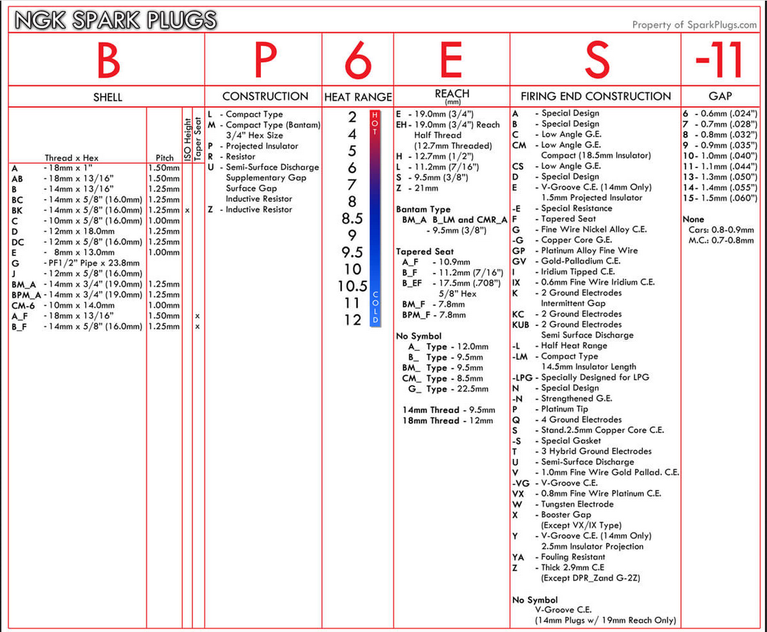

Well, without knowing your mixture at different parts of the carburetor circuit, it's hard to suggest jets and needle positions.
You could do plug chops on new plugs and that would get you to see what the carbs are doing in each circuit.
Plugs
The factory states anywhere from a B8ES to a B6ES.
See if you grab a pair of B6ES.
The plug will run hotter preventing the fouling.
You can also close the gap to make it easier on the ignition system to fire the plug.
Run your point gap to the smaller end of the spec. It may be .3mm. This will give your coil a bit more of a charge.
Check timing to make sure the gap adjustment didn't shift your timing
What you are trying to do is keep the tip of the spark plug above 900 degrees Fahrenheit but below 1600f.
If the tip of the plug is below 900f, you will foul the plug. Above 1600f and the plug will cause pre-ignition.
Photo:https://www.sparkplugs.com/Data/uploads/Charts/NGK_Plug_Chart_1.jpg
Plugs
