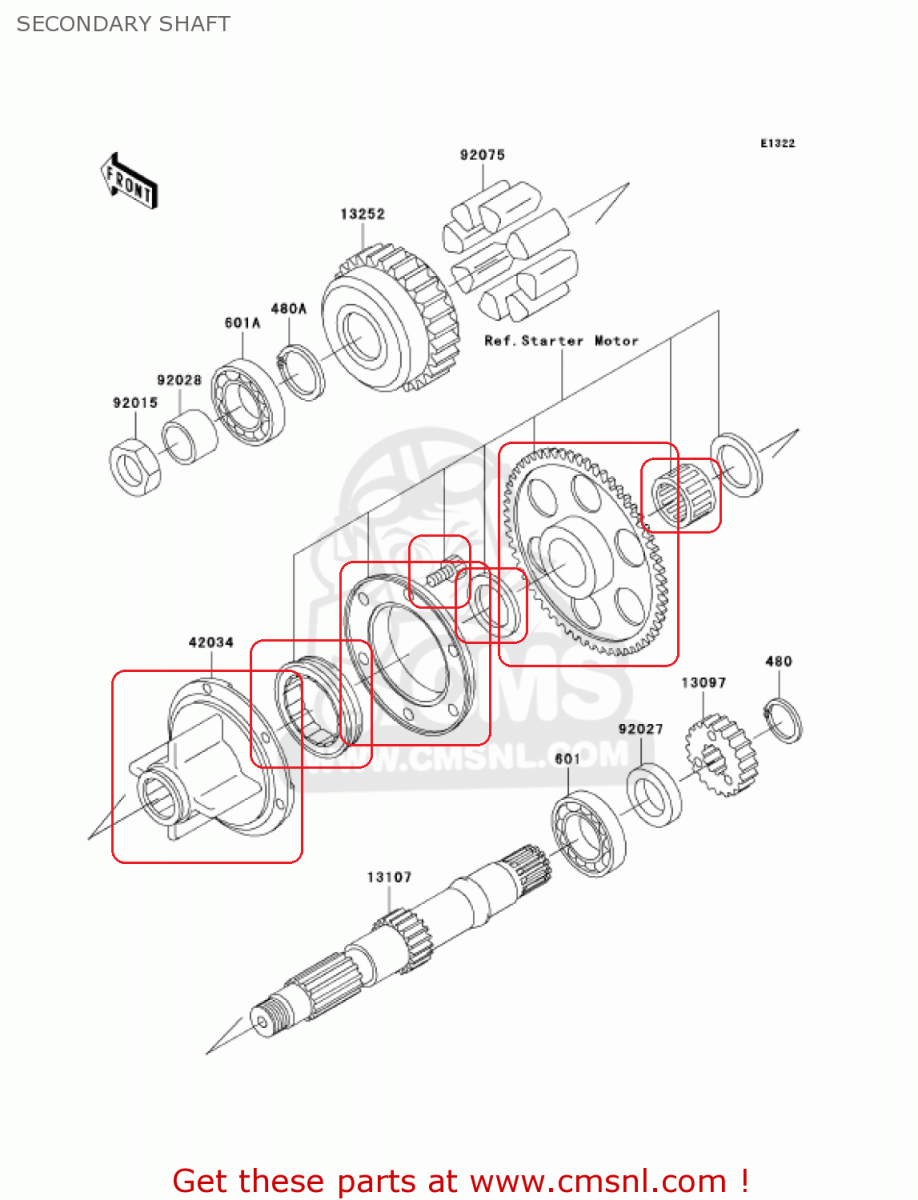

You guys know if that's a rebuild situation or a new starter deal?

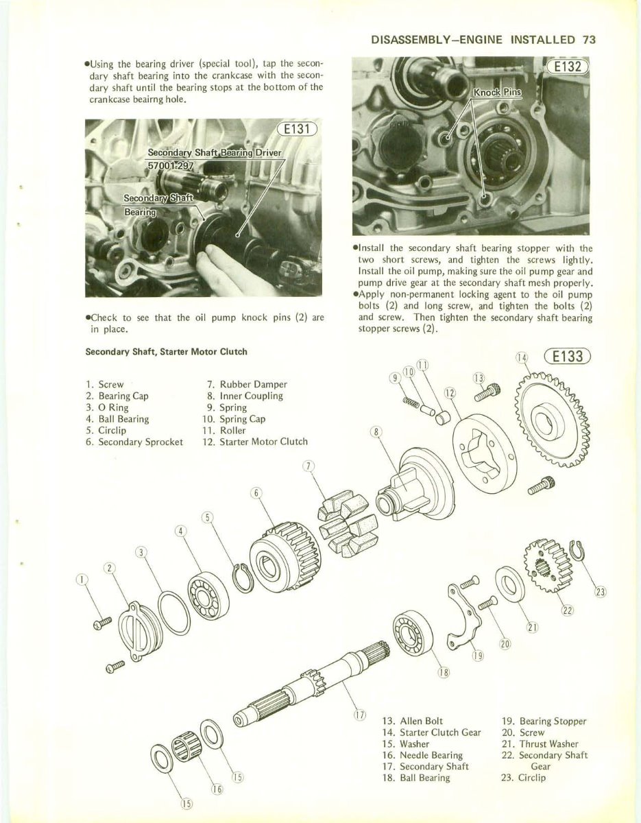

Re: Starting noise Help
06 Jul 2020 07:17
Is it best to take it apart to see what is damaged first? Or is it obviously the starter clutch?
Also, i can only find repair kits on EBay containing 9,10, and 11. None i see contain 12 and 14. Do you have a good source for the parts?

- Warren3200gt
- Posts: 1773
- Thanks: 953
06 Jul 2020 10:05 - 06 Jul 2020 10:07
Dont get a repair kit or you will be doing it again in a few months. You need to buy a whole new starter unit. Available in the uk from zpower for about £110.00. If z1enterprises dont carry them zpower will ship if your in the US/Canada
Replacement involves work to both sides and dropping the sump. Its located in the heart of the engine but can be done from underneath with the engine in.
