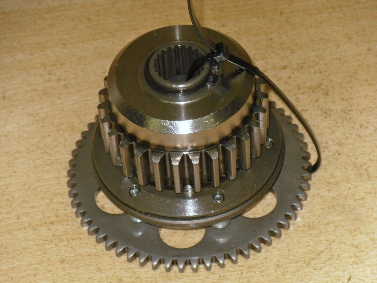

The Zephyr, ZR7 bikes took the kz650/z650 engine & transmission and slowly improved it over 2 decades.
One z650 weak point is the starter clutch. People change rollers, springs, but it appears that the most common issue are several things.
1. Low cranking battery
2. Synthetic oil or oil additives
3. Weak springs

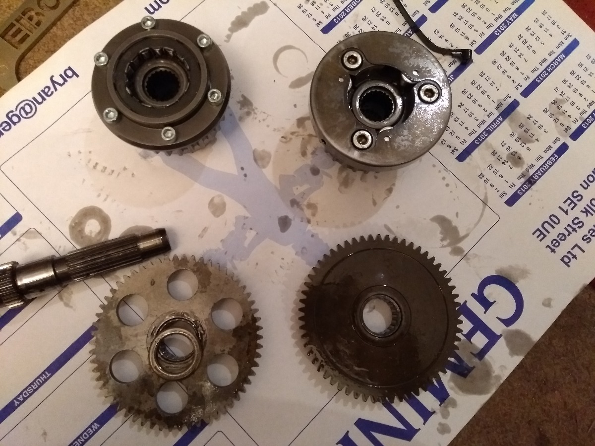

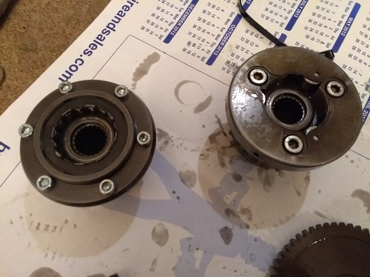

4. DENTS IN THE ROLLER RAMPS
The rollers are the only hardened parts in the centrifugal clutch, if the rollers do not evenly grip the 58T starter gear, they will dent the surface on the starter gear boss, or on the roller ramps. A low friction oil might make matters worse.
These dents mean the rollers do not wedge properly. The attached photos show dents. Note that this starter clutch was previously reground (by eye, with a Dremel, not recommended), which makes the dents stand out.

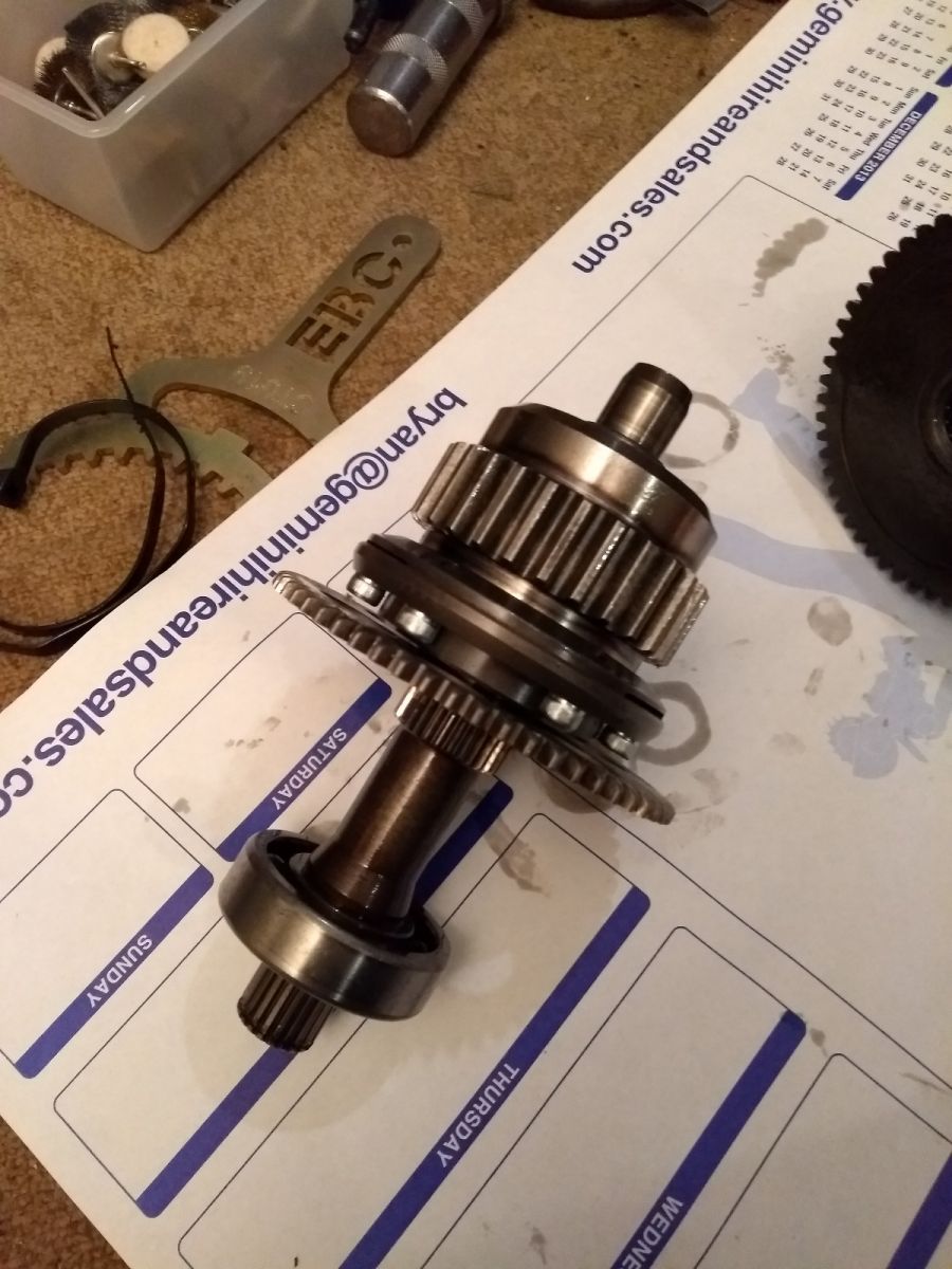

It seems that the Kawasaki engineers eventually addressed this weakness on later ZR models. The sprag clutch is replaced by a one-way bearing that distributes the stresses over a far wider area, drastically reducing plastic distortion of the bearing surfaces (ok, this is getting into tribology porn). The ZR7S starter clutch is on the left, the original kz650 part to the right of the images. The ring bearing surface for the 58T starter gear is a different diameter too.
The question is, can you swap it into a kz650?

Re: kz650 starter clutch solution - ZR7S part
20 Jan 2018 03:50 - 20 Jan 2018 03:50

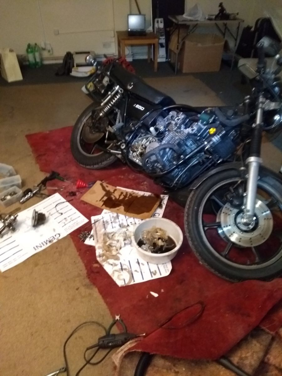

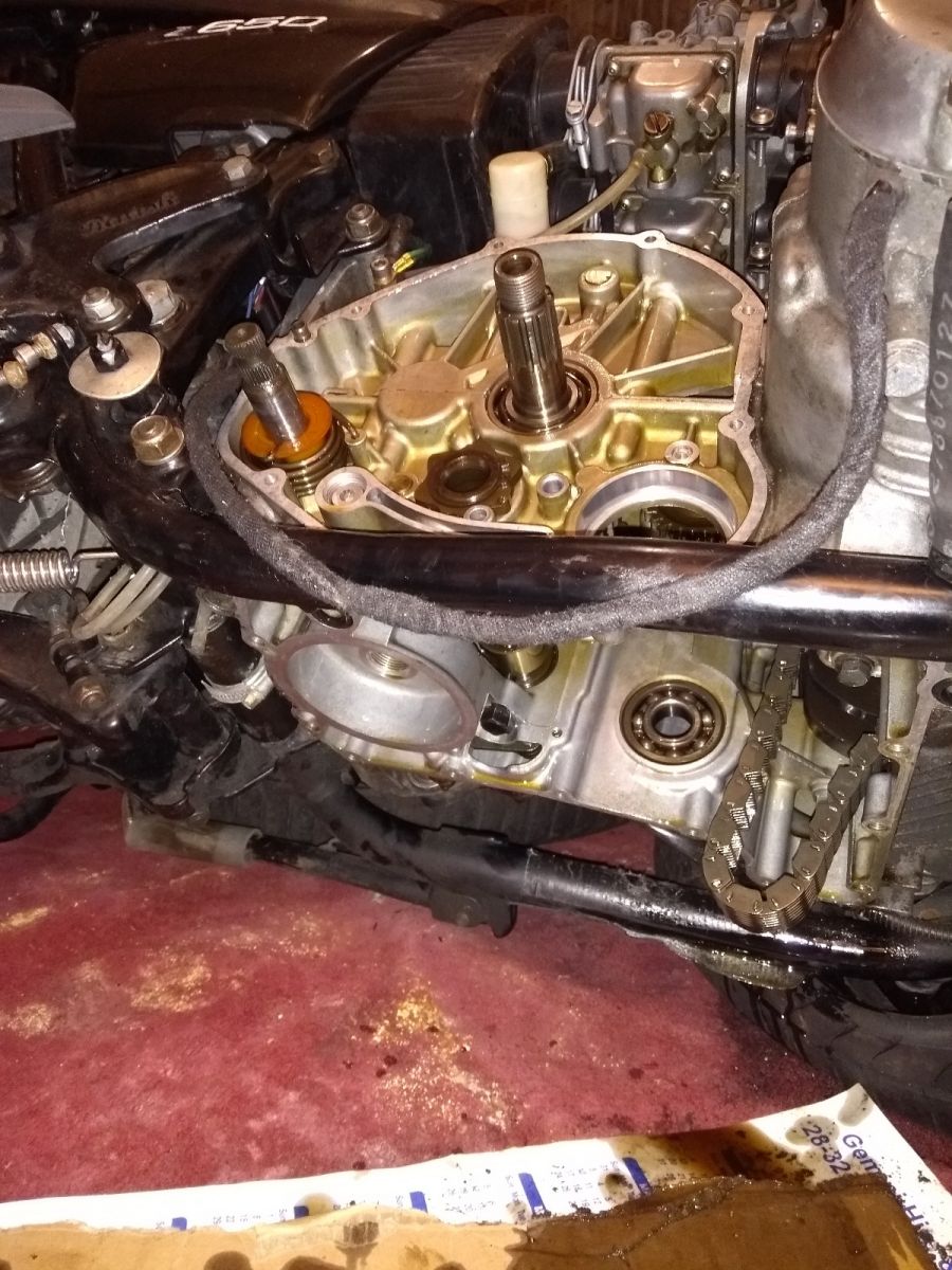

The answer is yes, swaps right in. No modifications required.
The technique for laying the bike on some tyres and performing surgery via the oil pan/sump is covered elsewhere.

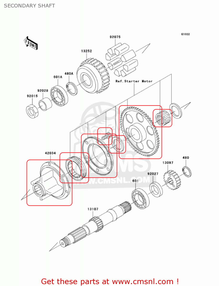

You really only need the clutch/starter gear assembly with the associated needle bearing and internal spacer.
The sprocket and rubbers are identical but I never see them sold separately.
Hopefully the attached diagrams make it clear what parts are swapped.

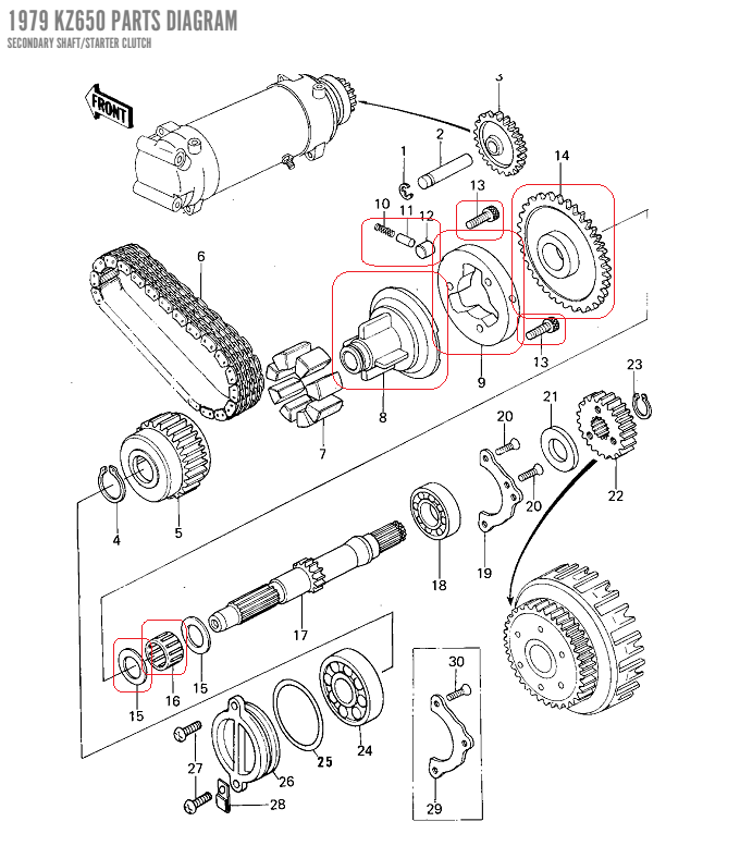

This is the kz650 clutch assembly with parts to be swapped highlighted:
These are the ZR750h1 parts that are used:
