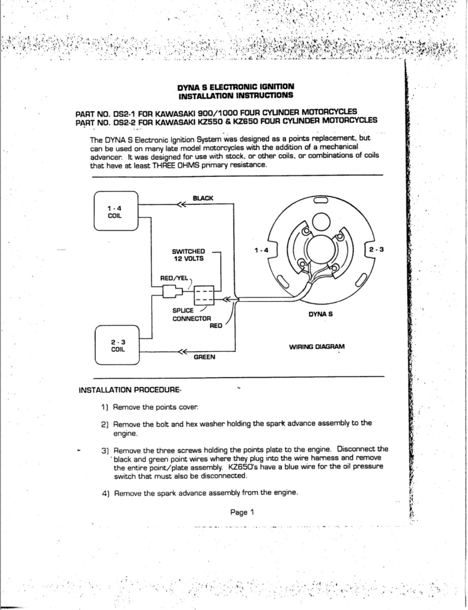

I think i found my problem as one coil just failed. My question is can i use OEM type coils with the dyna- s electronic ignition? I'm planning ordering one this week and 2 new coils but don't want to spend a whole lot on coils right now.

Yes any coil at least 3 ohms

Wow i never thought of that, thank you for your input. I just changed both coils and they were both cracked so i'm thinking a new ignition setup will fix my issues. i will be installing the electronic ignition tonight as a did the coils last night. Will keep updated when i get it timed in correctly.
