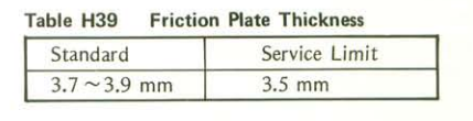

Hello All.
My 1978 KZ1000 A2 clutch is slipping on heavy throttle. I am going to try new springs first. Then, if needed friction plates.
Would any one know the minimum thickness and the new thickness for the friction plates?
your help is appreciated,
Ronnie.
Ronnie.

Re: Clutch friction plates ?
29 Jun 2020 12:22
Partzilla says …
9- friction plates
8- steel
Web search says steel plates are 2.3MM thick.... 8 x 2.3mm = 18.4mm
friction are 2.9 to 3.1 so 9 X 3.0mm = 27mm
18.4mm +27mm = 45.4mm if I'm doing math correct... here in the states we don't use MM as our first form of measurement... and I'm an Old School carpenter...
9- friction plates
8- steel
29 Jun 2020 13:04
The following user(s) said Thank You: Ronnie_D
29 Jun 2020 14:55
I yield to Nessism... part number Kawasaki 13088-030 is 3.8MM
