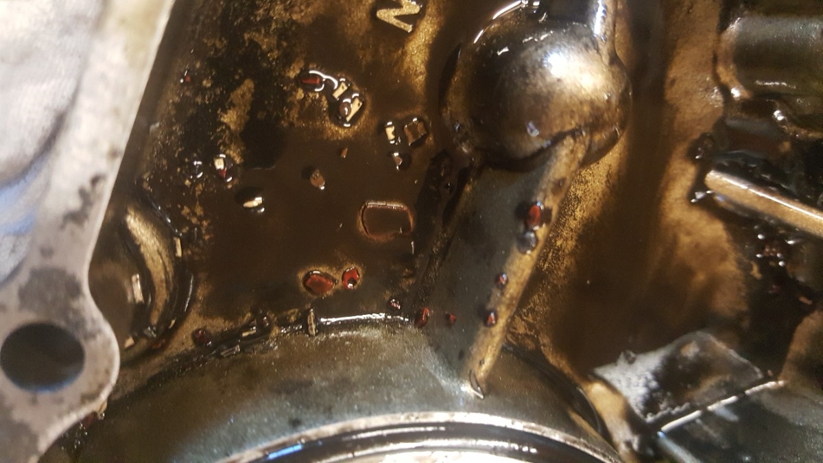

Need help identifying.
Red chips. Some small white particles.
In pan behind filter on clutch side.
1982 KZ1100 D-1

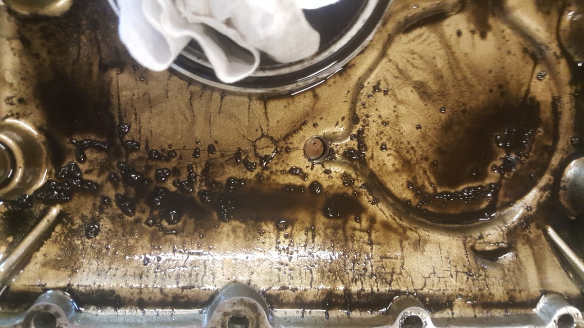

The stuff in the front under the crank is all black stuff from scraping of the base gasket.

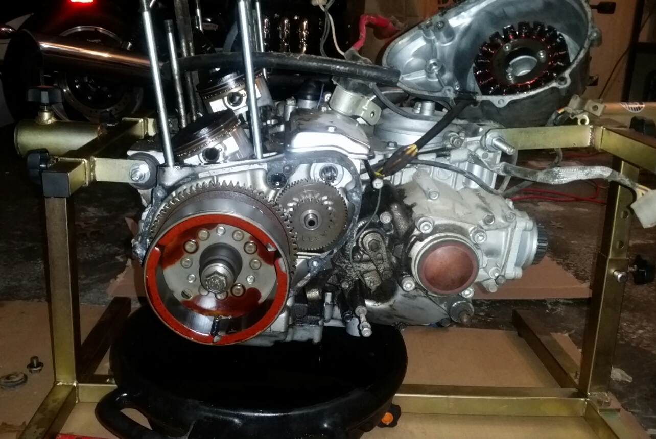

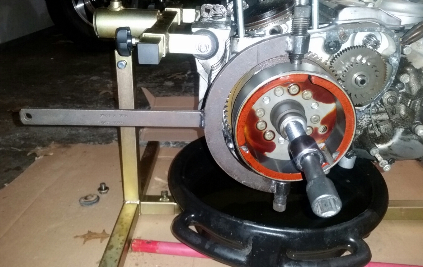

The red epoxy glue from the rotor magnets get brittle over the decades.

Yep. Dropped my pan and saw a chunk of something. Tried to pick it up with a magnet to see if it was steel and it repelled. Realized it was a piece of my old rotor.
