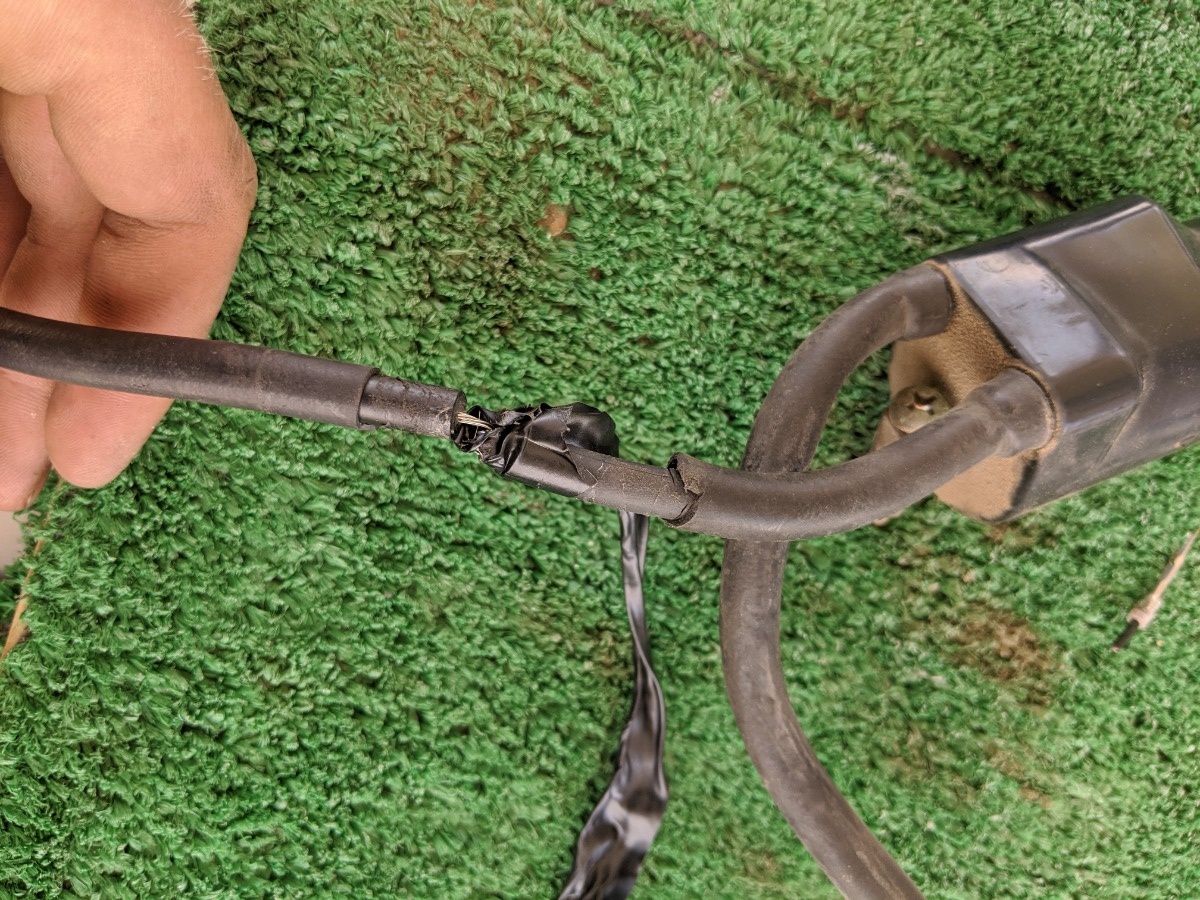

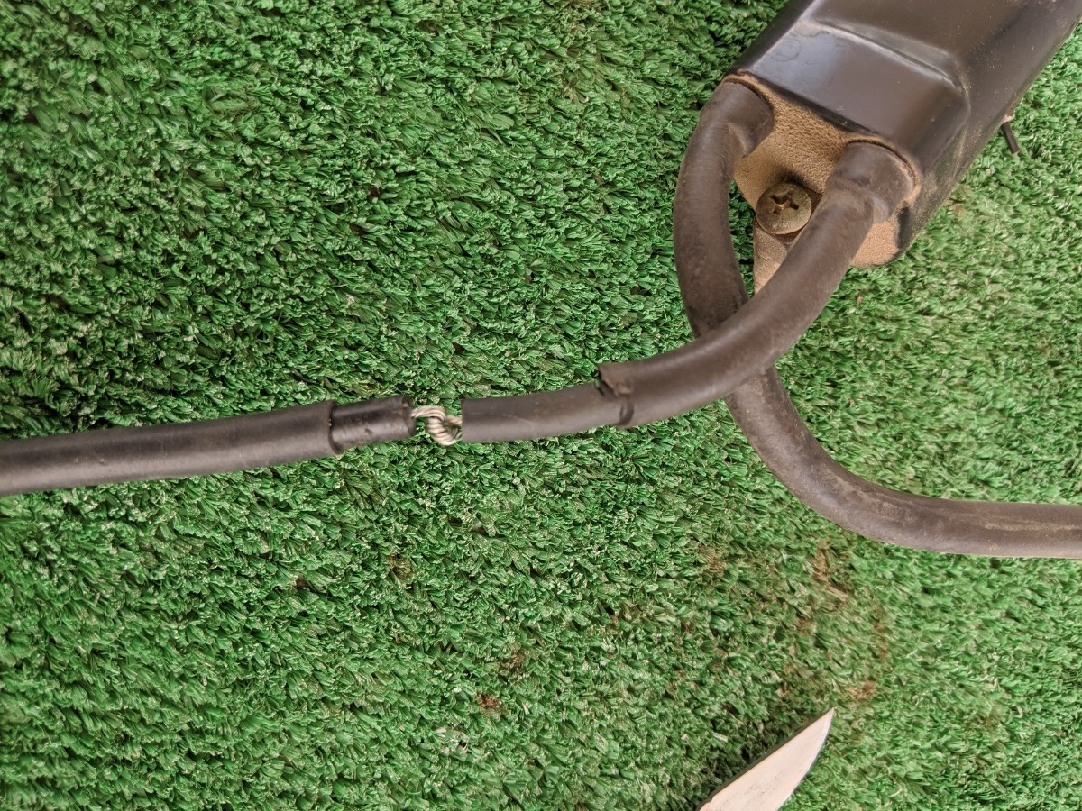

So I'm on a trip on my 1980 kz550 and ran into some issues with fuel mileage. I filled up at the pump and filled 3.2 gallons to 60 miles. I am glad I decided to stop because I almost ran out! This alerted me to an issue. So today I stopped by a mechanic and did some testing. First, I thought the boot on the first cylinder spark plugs was faulty as it was falling off over and over. Then, I thought that the high tension lead was arcing because the previous owner did a messy job splicing wires. After patching the issue and switching leads, (1&4) the problem still persisted. Our solution to bettering the high tension lead did work however so hurrah!

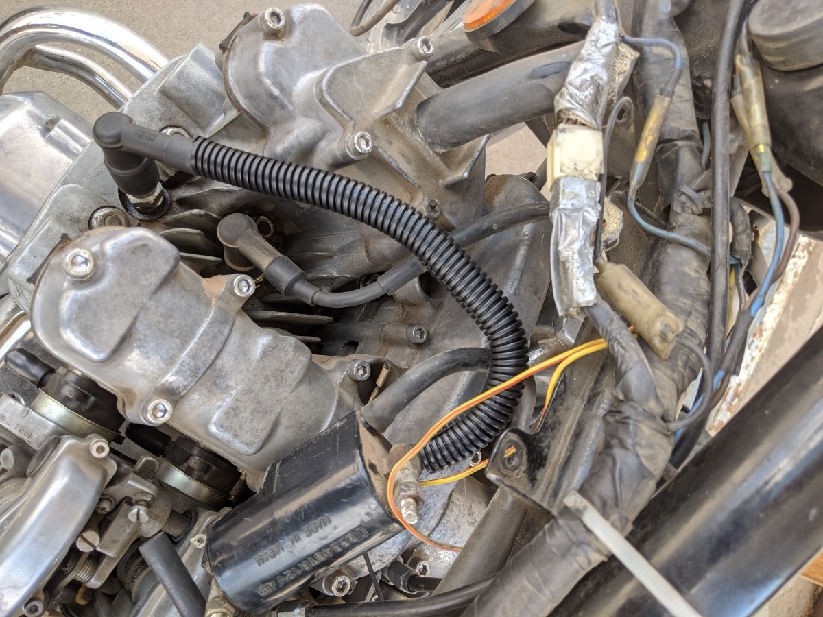

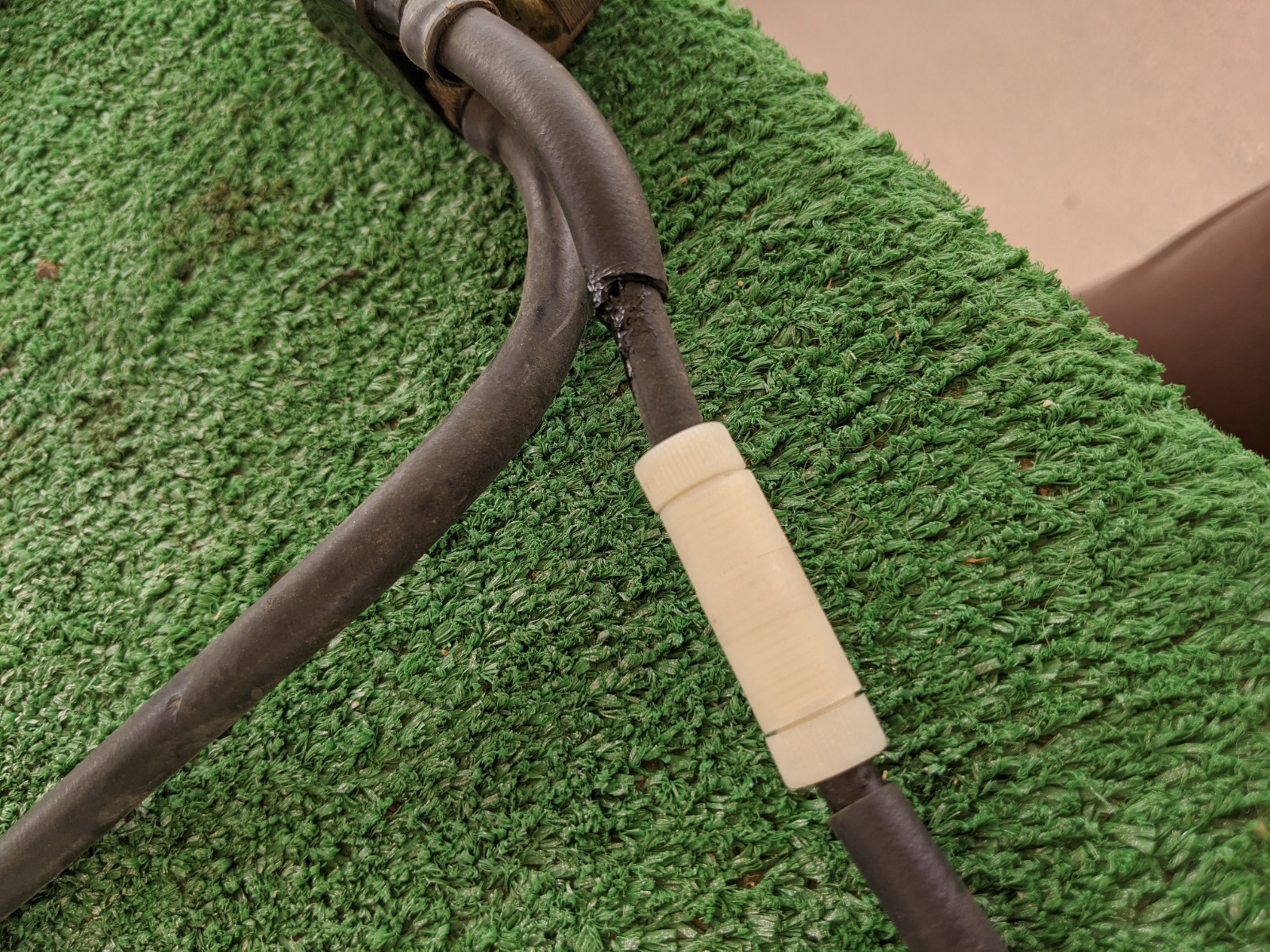

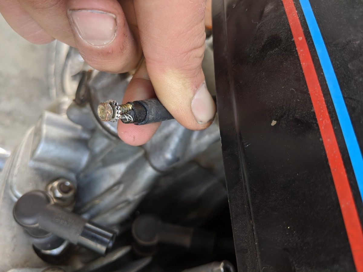

I have attached some pics for reference because it was fun to fix an issue that did not necessarily end up as an issue (the fix powered cylinder #4 when I switched the caps). Obviously it was not ideal to have electrical tape insulating spliced high tension leads.... Any thoughts, comments and questions are appreciated since I do have a distance to go and want to be as safe as possible for myself and the bike!

Regarding your coil wires, they should be fixed properly or the coils replaced. Typically the coil wires can be pulled out or screwed out of the coils. They fit down into a little tunnel with a spike on the end. You may need to dig out the wire with a pick tool but it's a doable project. The bike uses 7mm copper core HT leads which can be purchased at Z1 Enterprises and the like.
