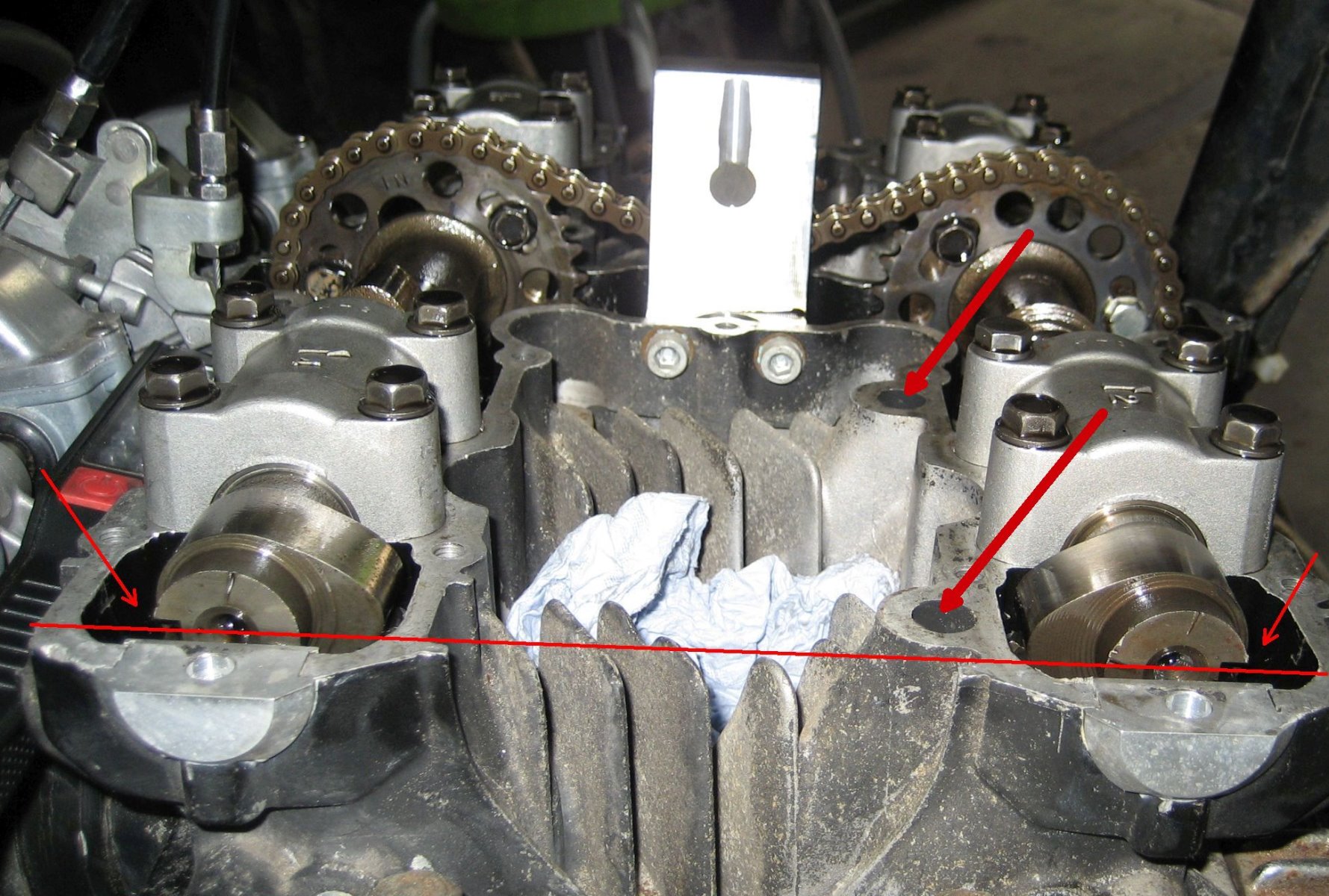

Did you remove the air suction reed valves in the cam cover? If you did, and did not plug up the exhaust holes beneath, exhaust will blow by the covers with the hose fittings.
