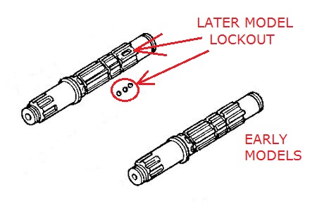

Ant_5445 wrote: This is normal on kawasakis. When at a standstill, the gear selector will only allow for shifting from 1st to neutral and back down. Try getting it out on the street and shifting. If you're still having problems shifting into higher gears then you have a gear problem.
That's normal on newer Kawasaki bikes, not all Kawasaki bikes. The 1977 KZ650 does not have that lockout. I believe it was first used on the KZ650 (and probably other model KZ bikes) in 1978. The original poster doesn't say what year bike he has, but if it's a model later than 1977 that is normal. Ed
