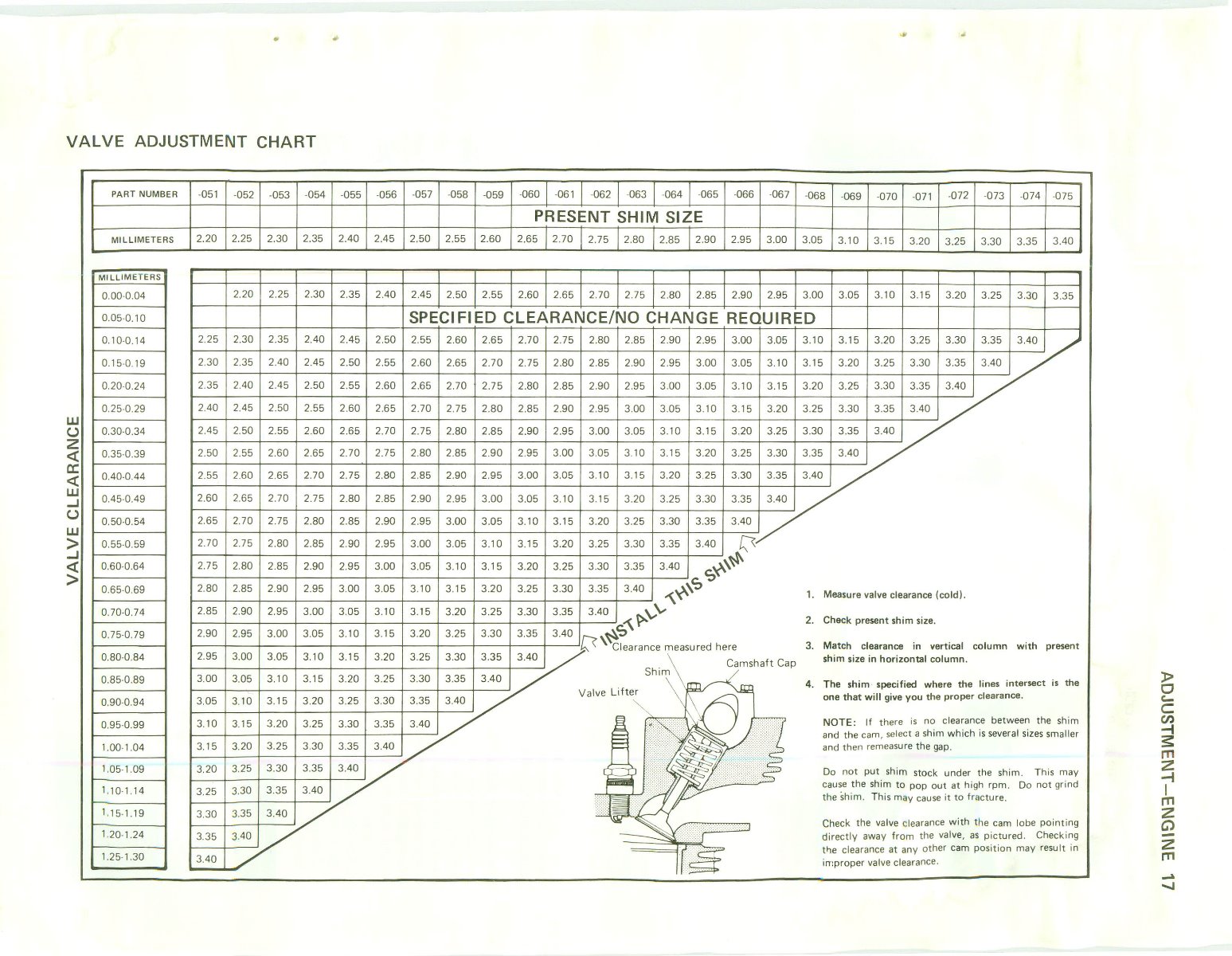

Checked my valve clearance today. Couldn’t get .04mm feeler gauge in any of them. How bad is it to ride it like this?

10 Jun 2020 17:28Ramchargerjay wrote: Checked my valve clearance today. Couldn’t get .04mm feeler gauge in any of them. How bad is it to ride it like this?
Very bad. The valves will burn since they won't close properly when hot.
