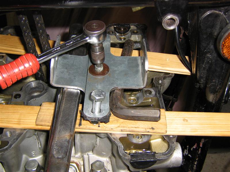

I have a KZ750-K1 (twin) and I am trying to get the cylinder heads off but I can't pull the blind caps out. Anyone have any recommendations? I tried everything I could think of but nothing seems to pull these things out.

You need a self made Extractor tool to remove the plugs.
Photo story: www.z750twin.de/zylinderkopfdichtung.htm

Thanks for the response! I will try this out tomorrow
