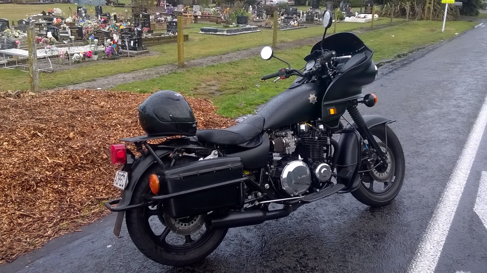

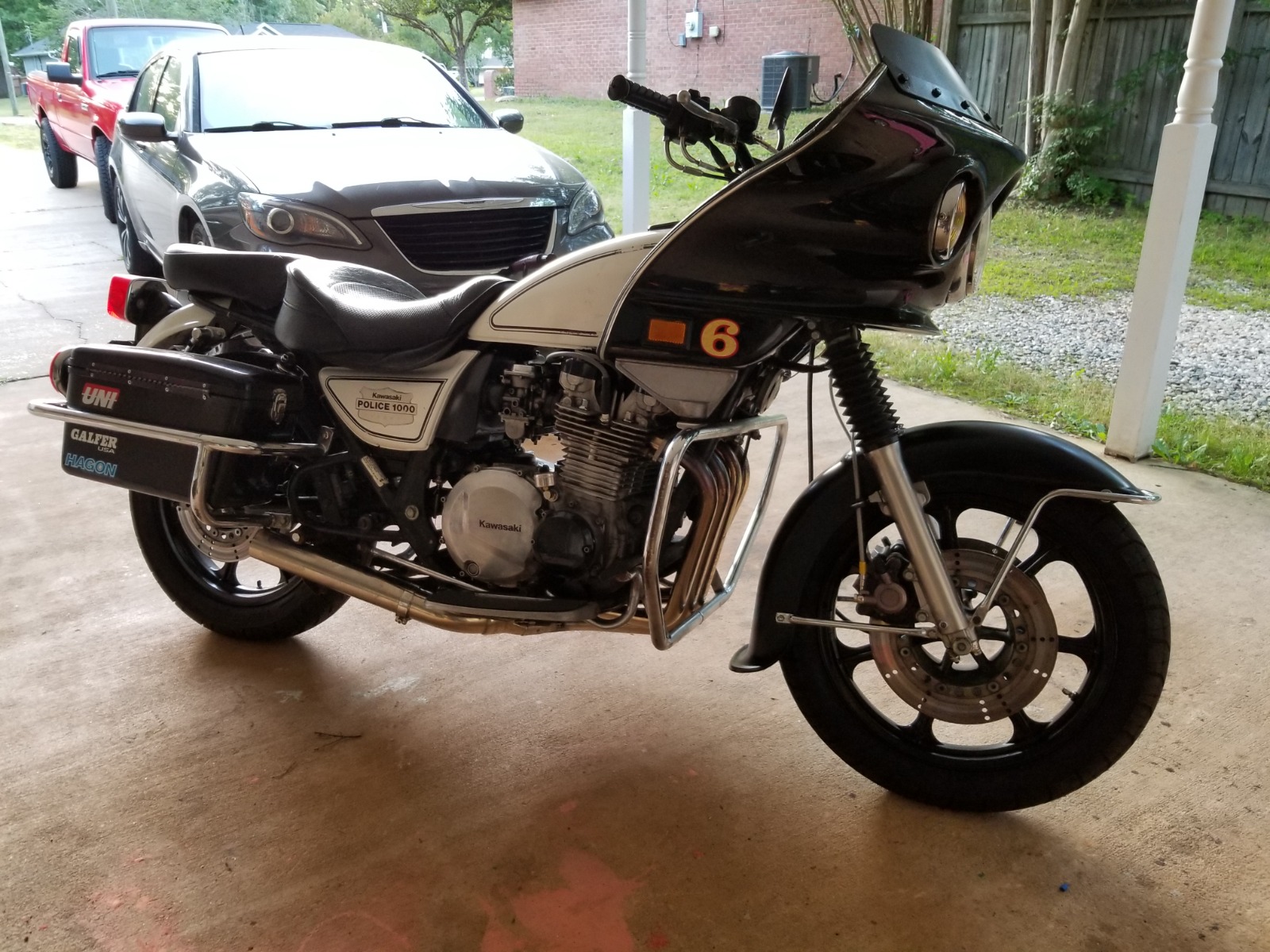

- Algoe
- Posts: 27
The following user(s) said Thank You: John6988
- John6988
- Posts: 5
Re: Kz1000p performance exhaust?
06 Jun 2020 17:10
That's a beauty, and it looks like the price is reasonable for them. All the ones I saw on their site look like they have more upswept muffler setups. Maybe it's an optical illusion. You have any more info?

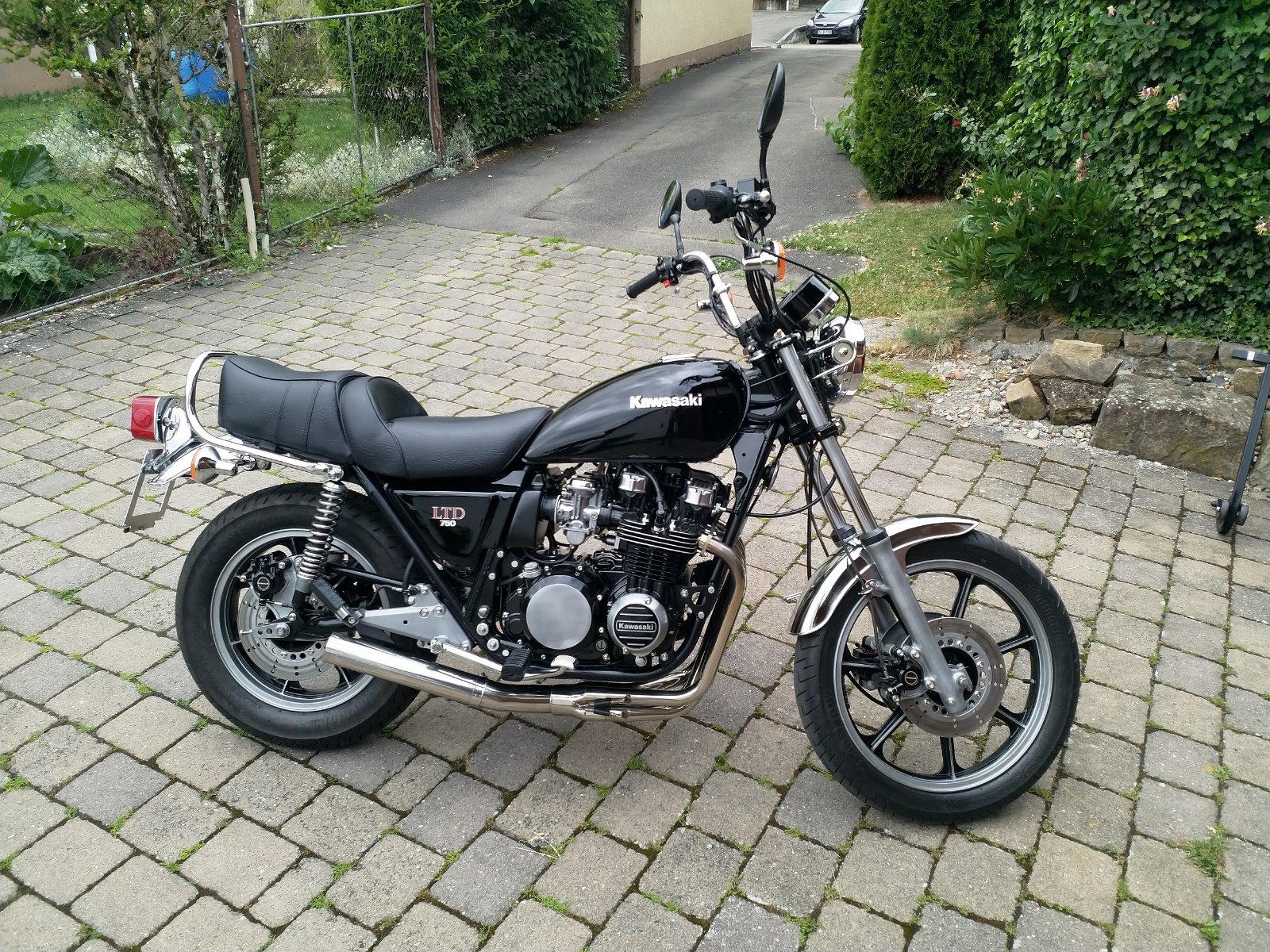

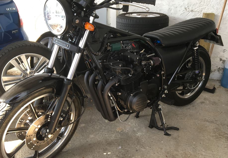

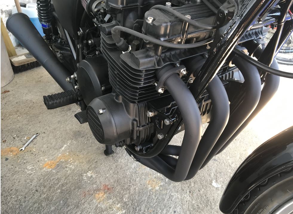

I`m also very happy with my Delkevic system. When I ordred it could I choice between two types, classic and cafe racer style? the small muffle was the cafe racer style. and I have the classic type.

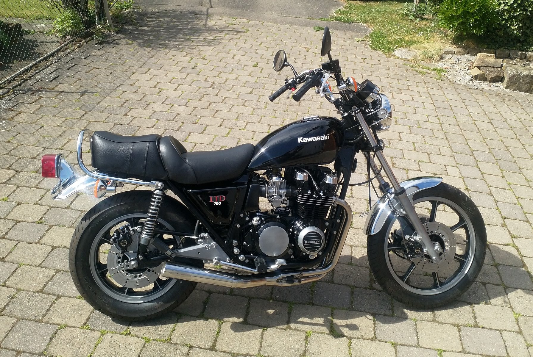

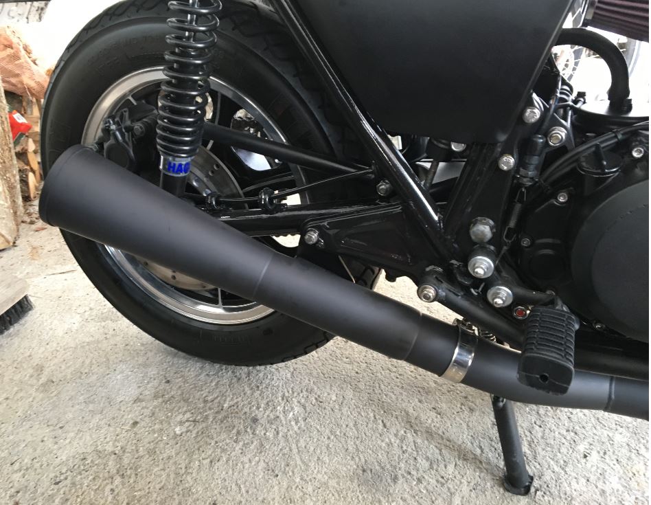

Can't comment on performance as I'm still waiting to get the bike registered (and it's a 750), but here's a couple of shots of the Delkevic from the side . You can see that the muffler is reasonably flat, not upswept as it looks on some of the photos. Pretty sure they use the same setup on the bigger bikes.
I did write to the guys at Delkevic in the UK to ask about their noise testing and they were pretty quick to respond and quite helpful. If they have any dyno data I'm sure they'd share if you ask.
