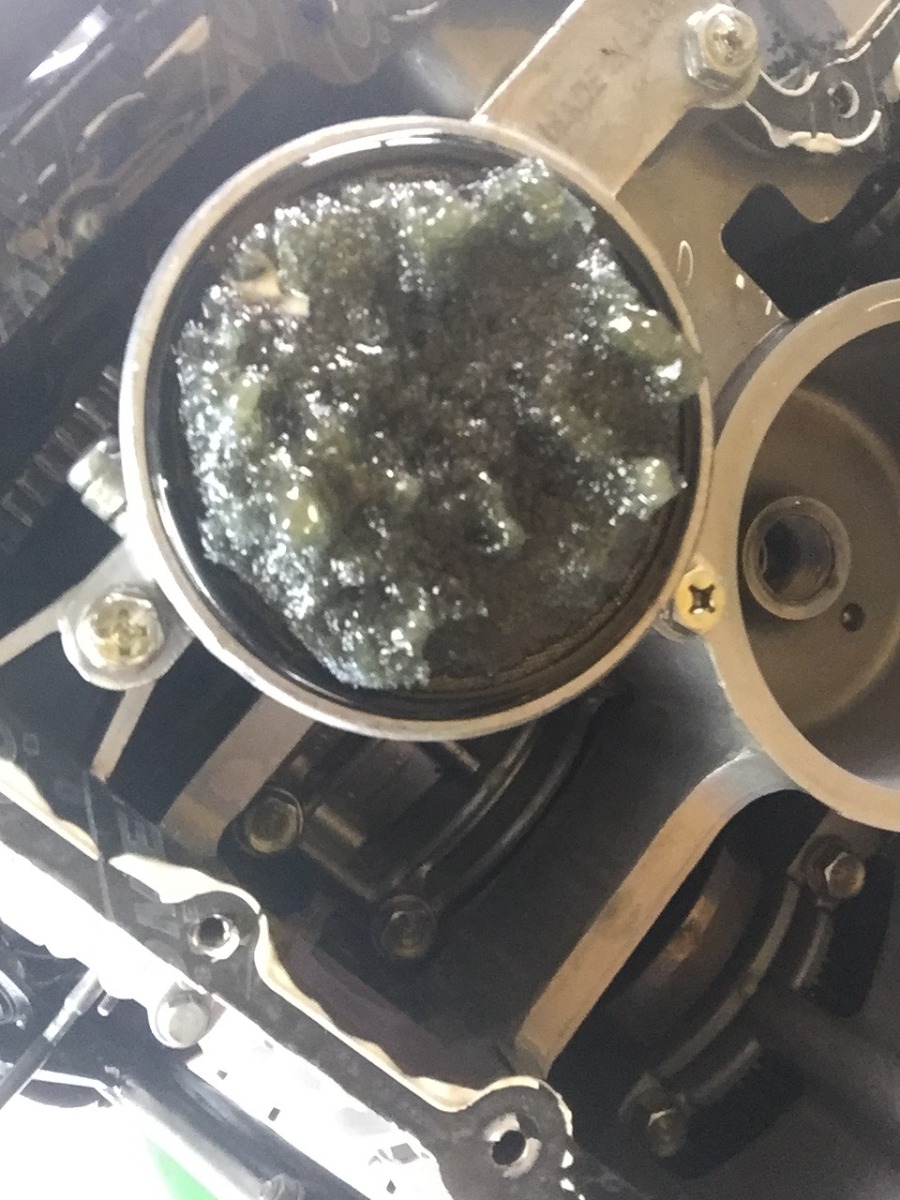

Remains of a kim towel on the oil strainer, accidently left in the engine during a rebuild.
