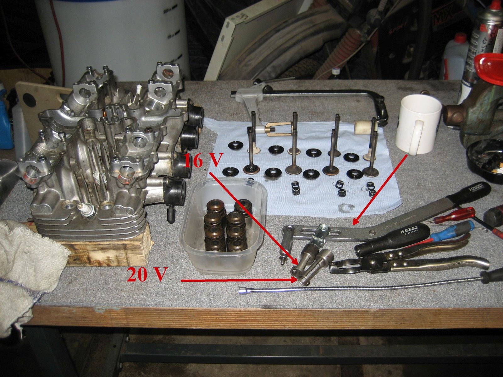

27 May 2020 08:41hardrockminer wrote: This is a KZ1000. You cannot change the seals with the head in place. The valve head sits between the combustion chamber and the cylinder. How do you get the compression tool on the head of the valve without removing the head from the engine?
Steve is correct. You must remove the head to do the job correctly. And yes, you will change valve clearance when you remove the valve.
The tool in Scirocco's post is a valve spring compressor that works without removing the cylinder head. Whether or not there is room to use it with the engine in the frame IDK. If the valves are returned to their original locations after removal, I don't believe the clearances will change. IMHO, Mike
