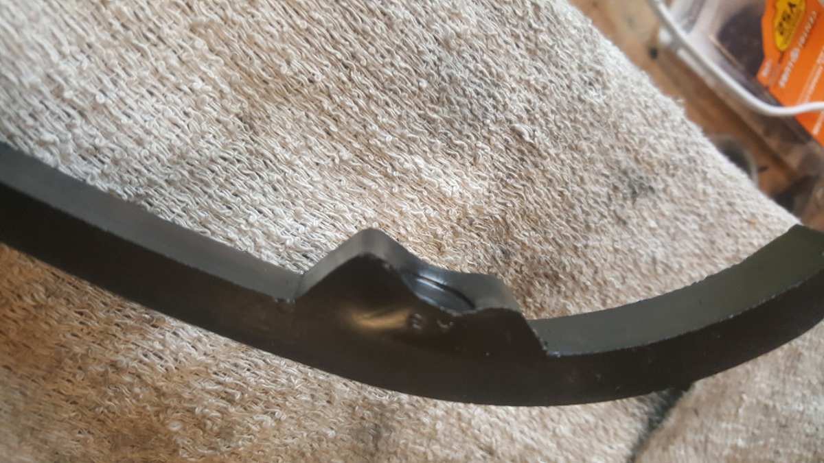

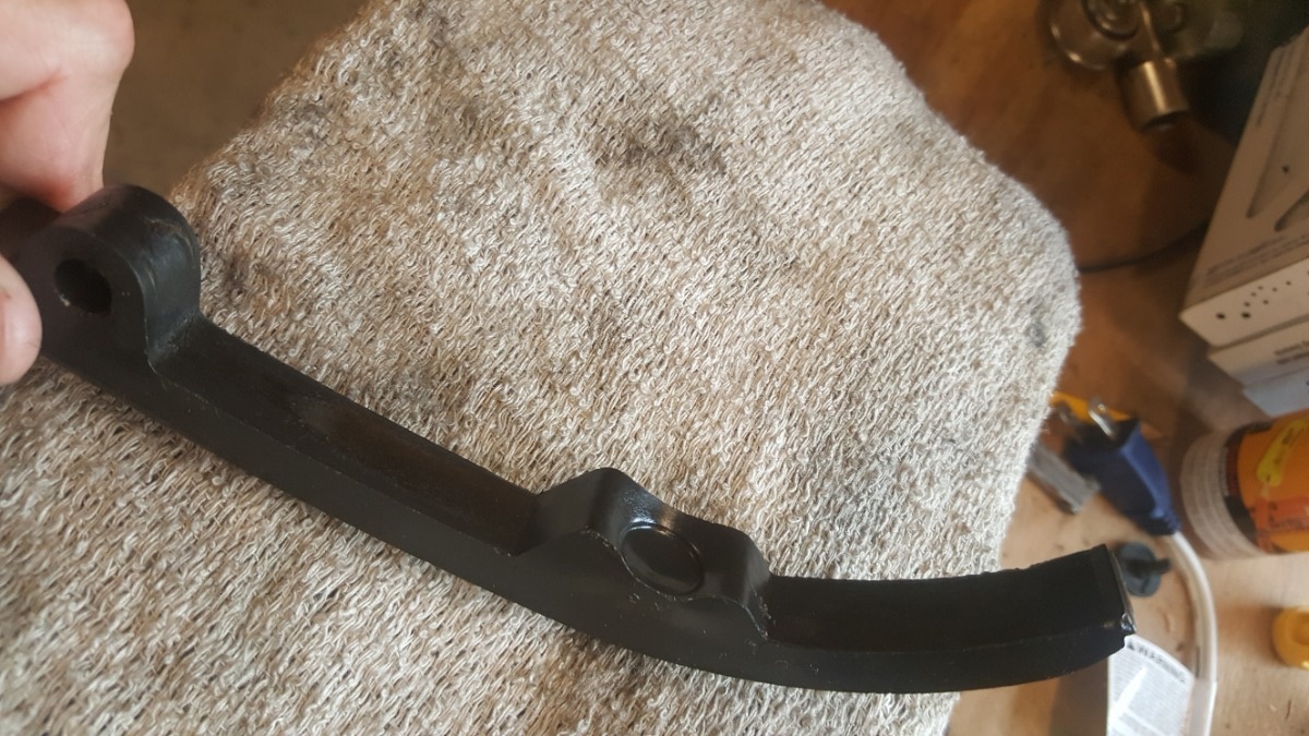

If replacing a cam chain guide, will the base gasket need to be replaced, too? Thanx

Assuming you pull the head then the cylinder should come off too and that means the base gasket. OEM gaskets are strongly suggested if you decide to do the job.

If you're pulling the head to change out the idlers on top of the cylinders you shouldn't need to disturb the base gasket. There is another idler under the cylinders and if you want to change that one at the same time you will have to pull the cylinders and change the base gasket.

24 May 2020 18:04The J engines use a Hyvo cam chain. There are no idlers, only rubbing blocks.hardrockminer wrote: If you're pulling the head to change out the idlers on top of the cylinders you shouldn't need to disturb the base gasket. There is another idler under the cylinders and if you want to change that one at the same time you will have to pull the cylinders and change the base gasket.

that my friend comes from someone pulling valve cover off W/O releasing tensioner , then reinstalling valve cover over tightning cam chain.

Probably hit the nail square on the head!! LOL
Living and learning can be rather expensive, but ya can't fix stupid LMAO!!
