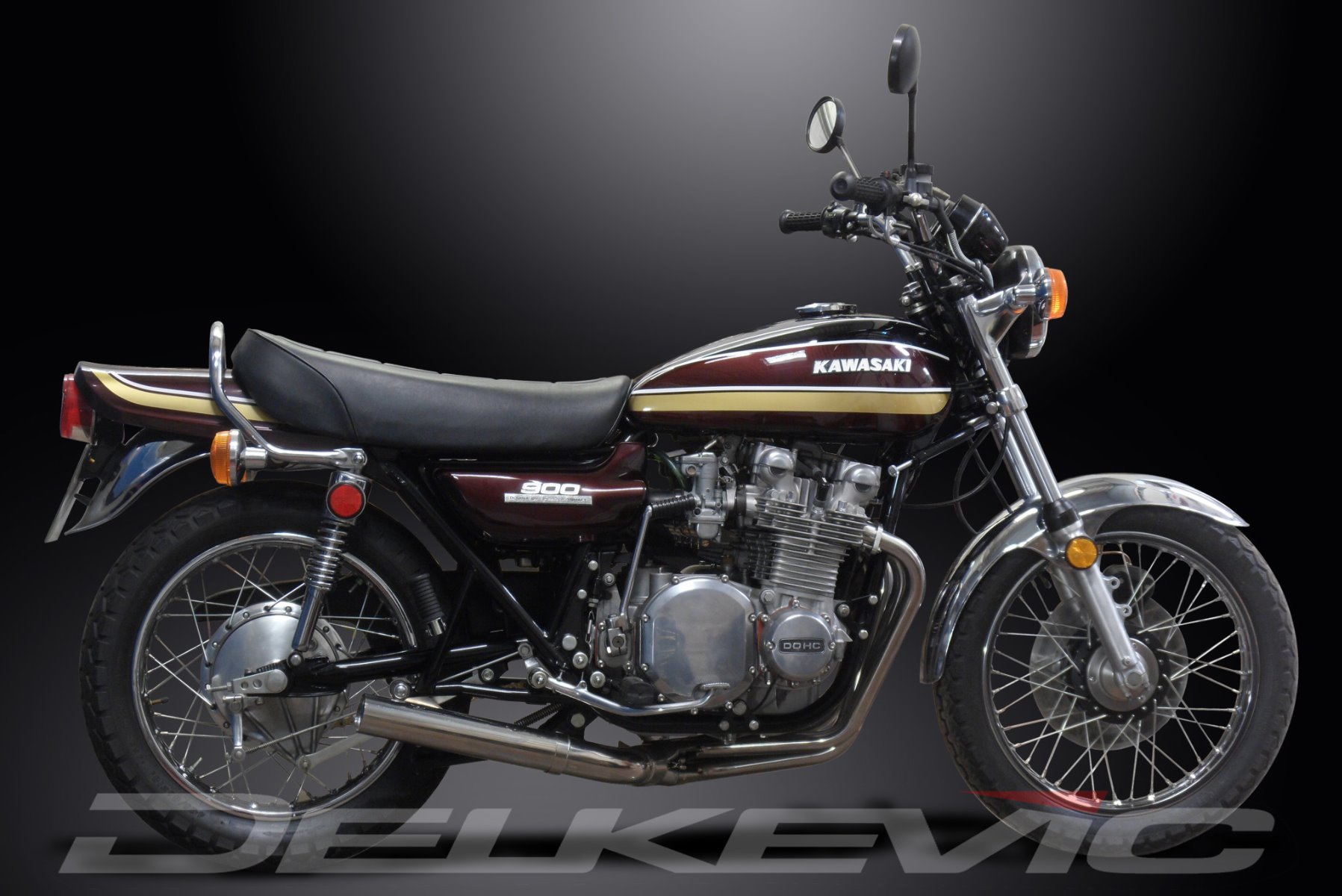

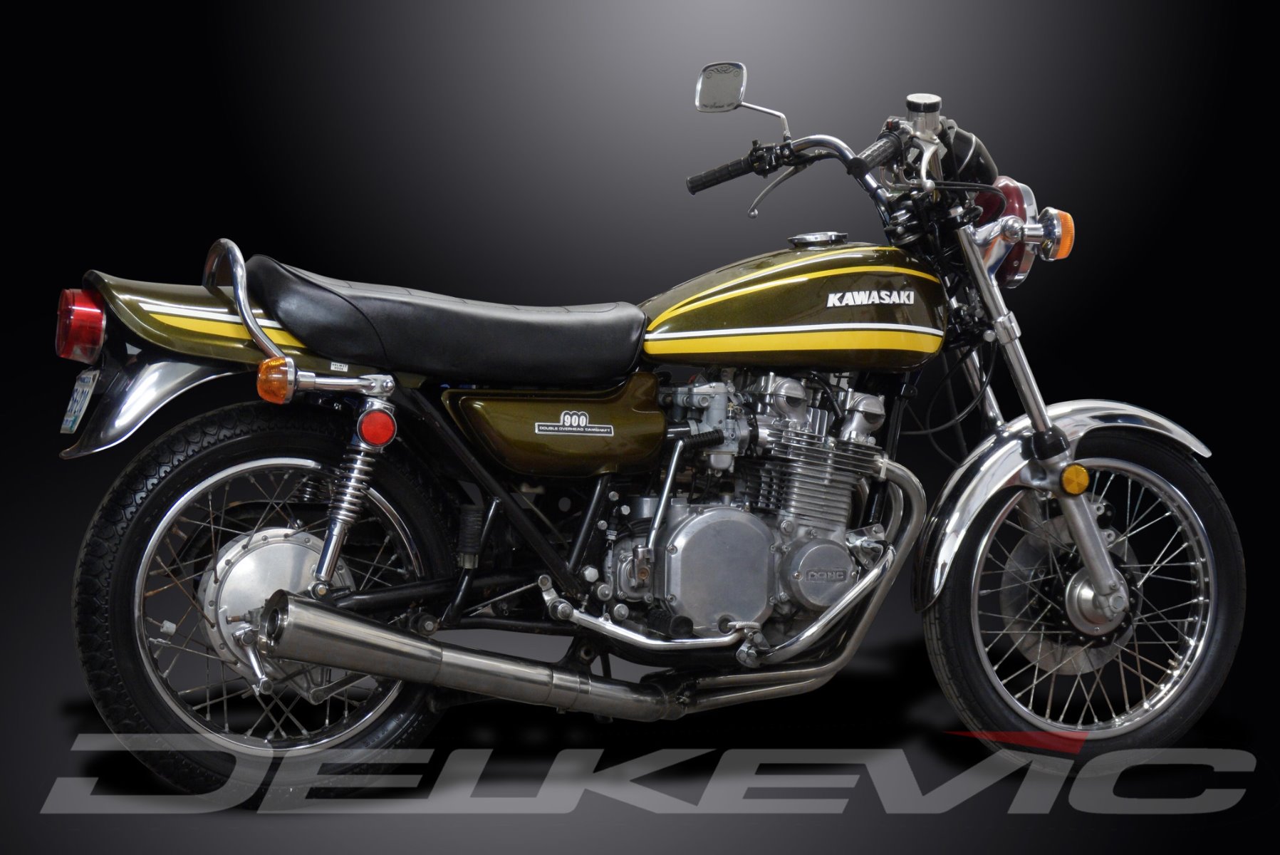

09 May 2020 14:45Scirocco wrote: I would take a stainless steel Delkevic System
+1

OP, you may already know this but it bears saying just in case.
Many 4-1's don't offer oil filter access. They have to be removed to change the filter. Too, there may not be any 4-1's that are compatible with the centerstand. It's been a long time, but seems there are (were) a few that allowed the centerstand to be installed just with the pivot bolts for use during maintenance, but would not allow the centerstand to park in it's stowed position.

Not sure about the Z1 system from Delkevic, but their 4 in 1 for the 750 gives you access to the oil filter and doesn't get in the way of the centre stand. I can't be sure, but I would assume it's something they pay attention to and not something that randomly worked out on the 750. I have been in touch with them regarding other matters and they are quick to reply. OP: if you are interested in the Delkevic I'd send them a quick e-mail to make sure.
