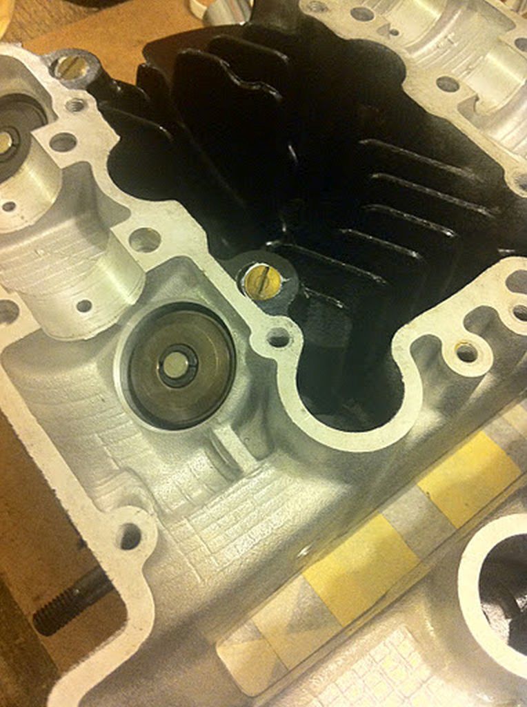

1982 KZ750-M1 CSR cylinder head. you can see the holes in the first pic & later pics.

Yes, the holes circled with green. Notice in your valve cover (or EB pic #6) that the clean air system holes in the valve cover line up with the holes in the cylinder head. Linked below are stainless steel set screws, as suggested by Scirocco. The hardware store might have something. You'll need to tap some threads. I would stuff something in the holes to keep metal shavings from falling down into the holes.

There might be a simpler solution, assuming you don't have a tap or access to a machine shop. I'm not 100% sure of the passage routing & I don't know the I.D. of the holes, but you might be able to glue aluminum rods into the holes using a high temp rtv. this would be easier than cutting threads. steell just used an epoxy to seal the holes, so alum rods ought to work as well. FYI, steell is kind of an expert on the 750 Twins.
