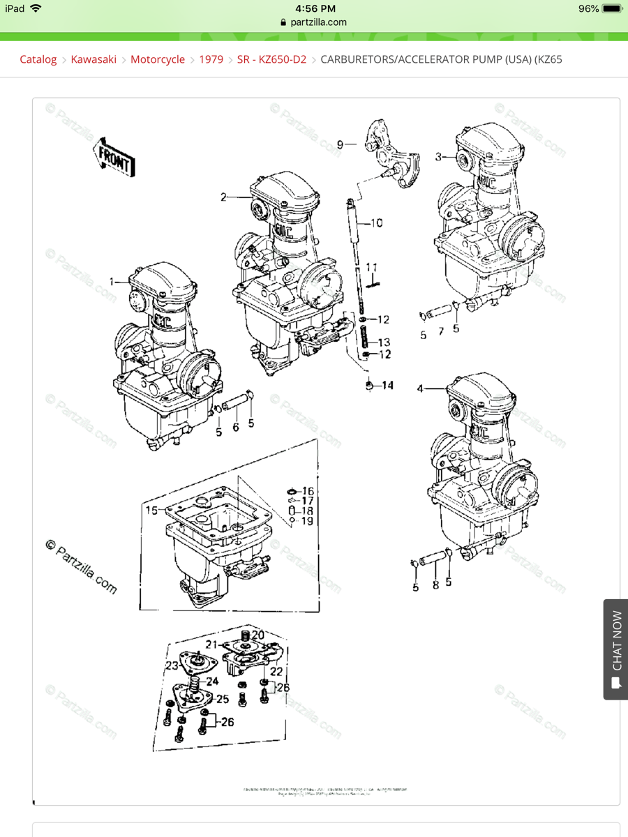

Is this what your carb rack looks like? If they are correct then the spring loaded gizmo is the accelerator pump

29 Apr 2020 06:15OK, that makes sense. Accelerator pump. I might fool around with it later today, but the weather is supposed to be beautiful, so after work I may take another bike out for a ride to clear my head. This one can sit until over the weekend.

There's an idle screw on the carbs (it's a thumb screw), which I don't have a picture of, but if you turn it left and ride, it'll change the idle speed. You can easily use it to lower your idle RPMs. Mine is adjusted so the bike will start and idle, but once fully warmed up, it idles closer to 2,300 RPMs. If I lower the idle once the bike is fully warm, it won't start.
As to my carb issue, I decided to tinker with it today, and went out and tapped the #2 float bowl a few times with a screwdriver handle, and then fired the bike up. It started right up, went off choke, warmed up fine... and no leaks! Took it to do a wellness check on my mom (she's fine, thanks for asking LOL) and 15 miles round trip saw no issues. Bike's clutch engaged perfectly, bike took off from stops better, no leaks. The only issue was the wind - 20-25mph gusts added a little rear end wiggle at times, but I had fun.

04 May 2020 15:22drakhen99 wrote: There's an idle screw on the carbs (it's a thumb screw), which I don't have a picture of, but if you turn it left and ride, it'll change the idle speed. You can easily use it to lower your idle RPMs. Mine is adjusted so the bike will start and idle, but once fully warmed up, it idles closer to 2,300 RPMs. If I lower the idle once the bike is fully warm, it won't start.
-John
You still have a problem. Probably clogged pilot circuits, or possibly a problem with the enricheners. You should start a new thread in the carburetor section.
