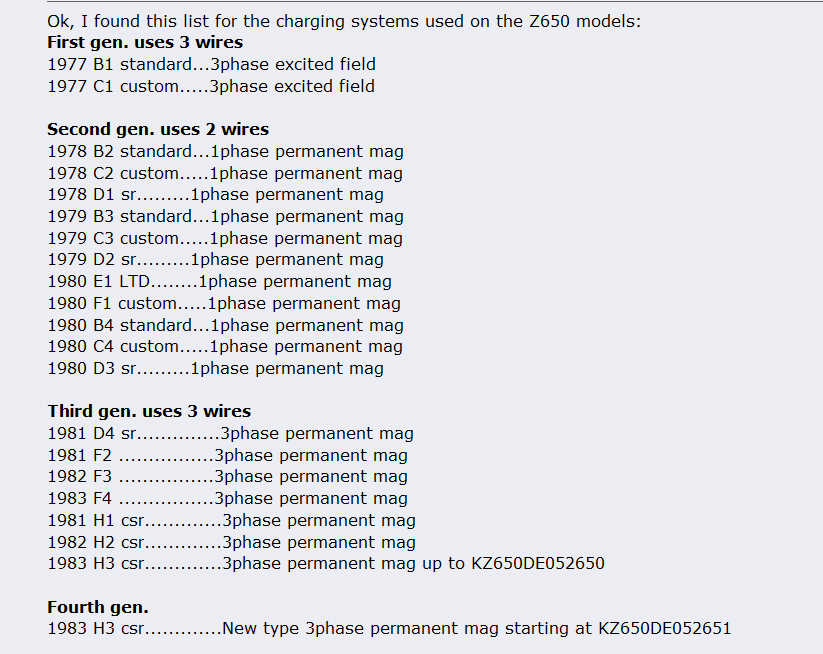

Be careful using that 1977 manual because there are major differences between the 1977 KZ650 and other models. One totally different system is the charging system - the 1977 is not at all like other years. Ed
