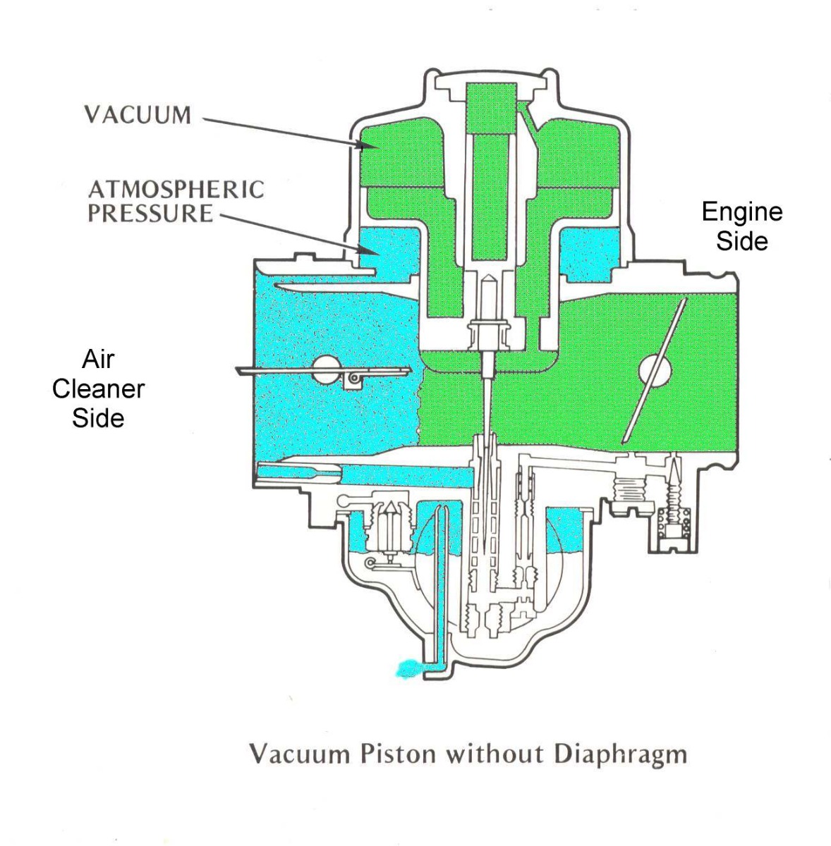

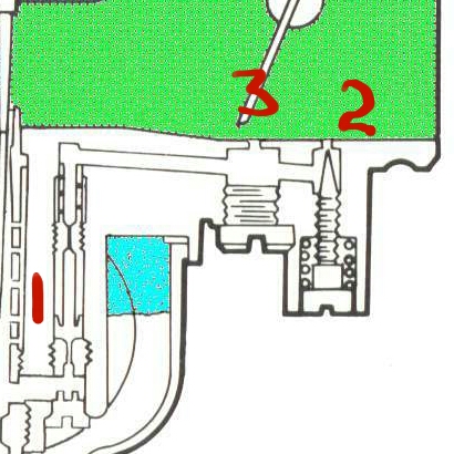

If those are CV carbs there should be 2 small ports on the intake side of the throttle valve. Those need to be clear for it to run. Look up the diagram and youll see how they work. IIRC, you need to plug one opening while spraying cleaner through because its a 3 way port.
This is similar to how it works, one of the 2 ports feeds fuel all the time and the other is metered by the screw. Remove the plug covering the screw if there is one so you can spray cleaner there, count the screw turns first. You need to alternate blocking the air screw port, slow jet port and the 3rd small port (which is probably the clogged one).
