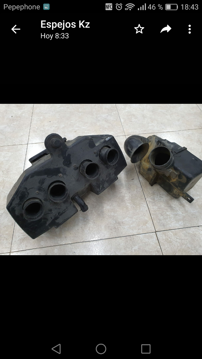

Hi everyone,
See if you can help me, I have a complete air filter box.
What model is Kawasaki from?
The seller told me it was from KZ 1000
I have doubts.
I bought it at a good price for my KZ1000.
It will take a few days to arrive.
I have doubts.

Possibly = 1979-80 KZ1000-E1/E2 Shaft. Diagrams >> Partzilla
1979 KZ1000-E1 (Shaft Drive) Air Cleaner diagram. (1980 KZ1000-E2 is probably the same):
www.partzilla.com/catalog/kawasaki/motor...z1000-e1/air-cleaner
1978 KZ1000-A2 (Chain Drive) Air Cleaner diagram. (same as 1977 KZ1000-A1):
(probably the same as most 77-80 KZ1000 chain drive models):
www.partzilla.com/catalog/kawasaki/motor...aner-77-78-a1-a2-a2a
