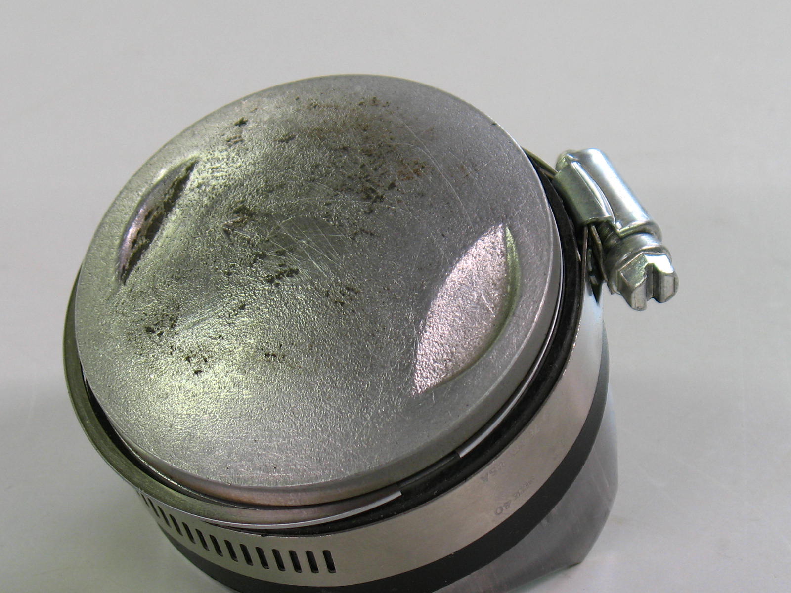

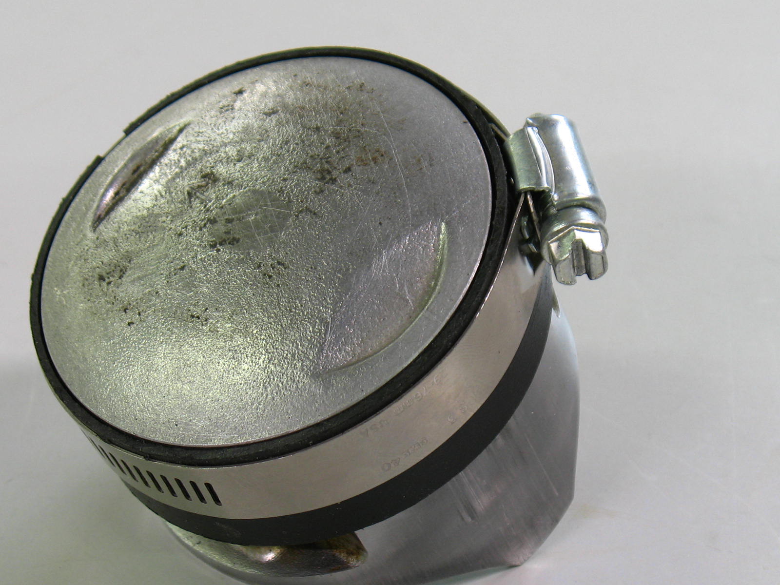

I can’t find the post from our member that shared this method with us. This is not his picture but one I found similar. Maybe other members will remember the post and find the picture. But this one shows the basic idea. I can’t help you with honing part of you question.

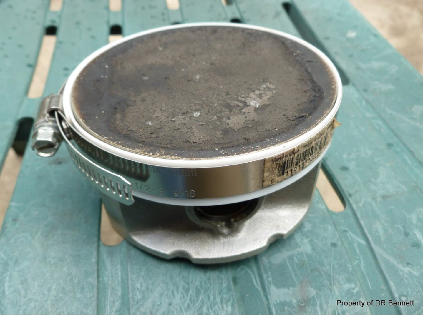

07 Apr 2020 09:13 - 07 Apr 2020 09:15This method will allow preset ring orientation to be maintained throughout the installation process.
