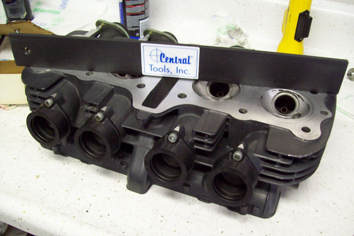

Everybody has their own opinion on how to put their motor together. Well here is mine!!!!
When I back off the head nuts, I loosen them in a reverse pattern of the assembly sequence. And I loosen them maybe a half turn at a time. I NEVER loosen one head nut all the way then proceed to the next head nut.
Make sure both the head and barrel are flat. Invest in a good straight edge to check them. A piece of steel is not going to cut it.

A good quality straight edge checking for warpage

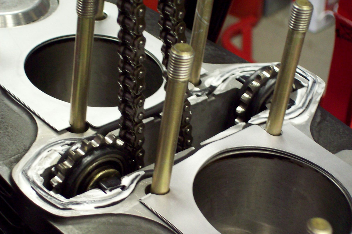

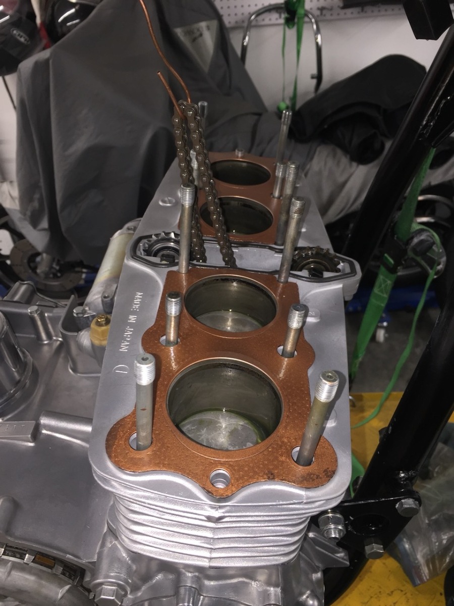

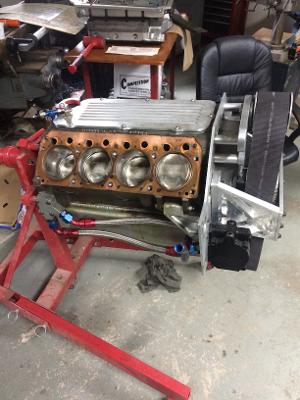

Nothing special with the center 0-ring. Just be sure it's in place before sliding the head onto the studs. I don't use a lot of Permatex...just enough to make the gasket a bit tacky (both sides) so that it seals on the metal face. It's also really important to have both metal faces ultra clean....Here is my most recent one from this winter.
