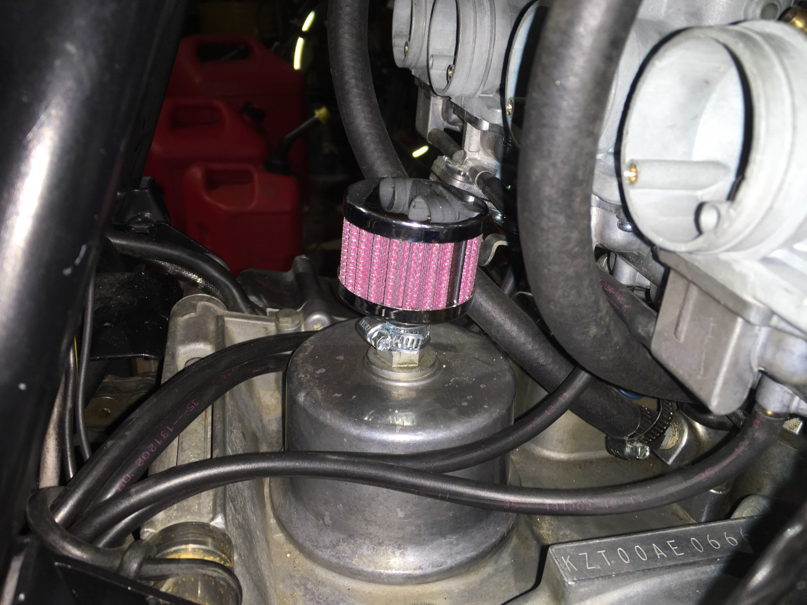

All you need is a small breather that fits on the stem from the crankcase. If you just use a piece of hose it may kink causing excess crankcase pressure.
The stock setup is just a tube going to the airbox.
Edit: z1parts.net/z1-900-kz900-kz1000-crank-ca...ther-blow-by-filter/

03 Apr 2020 16:33650ed wrote: If that is true, wouldn’t a vacuum eventually develop inside the crankcase since air would go out but no air would come back in? Ed
I was thinking this is how the PCV system on modern engines work, but I read a bit and it seems a second great air intake vent is required.
en.m.wikipedia.org/wiki/Crankcase_ventil...se_ventilation_(PCV)
Given that the kz engine only has the single vent, a check valve wouldn't really be the same as a real PCV system. But I'm guessing at speed there would be enough blow-by, and very little vacuum (vented to atmosphere) that I can't image any real negative pressure in the crankcase.
I suspect you could find an in-line PCV at the auto parts store that would work as a check valve to prevent back flow.

Agree with DOHC, and think WCO worries too much over nothing.
Initially, the crank was simply open to the atmosphere, until someone realized it was making pollution worse. The PCV was developed in WWII for military vehicles to function under water. So it was to prevent water getting through the crankcase ventilation.
In modern cars, initially the crank was ventilated to the intake manifold, but at idle, this extra air made it too lean, so the PCV valve also regulates WHEN and HOW MUCH goes to the intake manifold depending on engine speed.
Because in this simple old bikes the Crank ventilates to the air box, then a PCV or PCV control is not needed. ...and because of the pumping of the cylinders, ….yes...the cylinder pump up and down, .....the crank will always have a higher pressure.
So too me this is like having a gravity fuel system what is simple and works well enough, and someone trying to add a fuel pump to make it 'better'
......and agree than simply adding a filter pod to atmosphere, is bad, as it pollutes badly and is VERY, VERY NOISY....

Thanks to everyone for your thoughts. I probably was overthinking things and it seems that there are plenty of Z bikes out there that are running the simple fix with no adverse issues. I hope to be testing it out in a few weeks.
