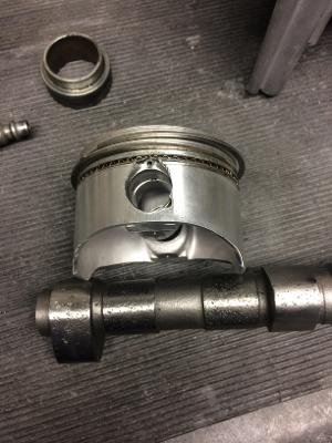

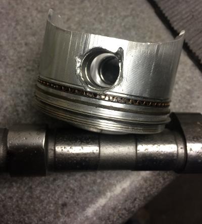

I wish this Numbskull did!! He ruined a new 72mm piston! I bought a parts lot thinking they were good. Not! Buttons are good You might have to machine wrist pins? Without seeing stuff in my hands, It is doable.
Check this cluster blank out! Teacher needs to sit him in the corner with a Dunce hat on!

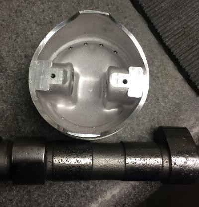

No need to machine wrist pins. I'm using the ones from the MTC pistons which are shorter to fit the buttons in a 72mm bore. And of course pin diameter is the same since they both fit the same connecting rods.
See the holes in the pin bosses in the underside picture of your piston? The MTC pistons have those, but Wiseco does not. I'm worried that the buttons may restrict oil between the pin and the pin bosses, and Wiseco pistons don't have those holes to compensate. See what I mean?
