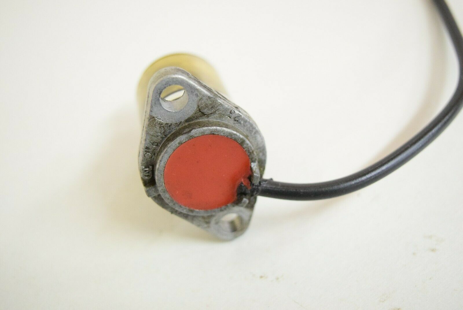

Here is the oil level switch on the spectre:

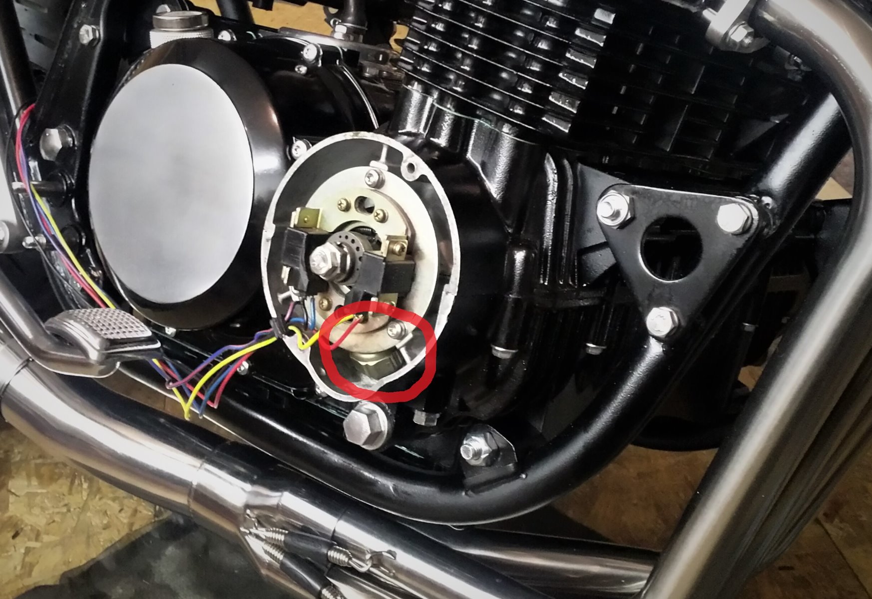

And you can just see the oil pressure switch under the pickup coils on my 750H here:

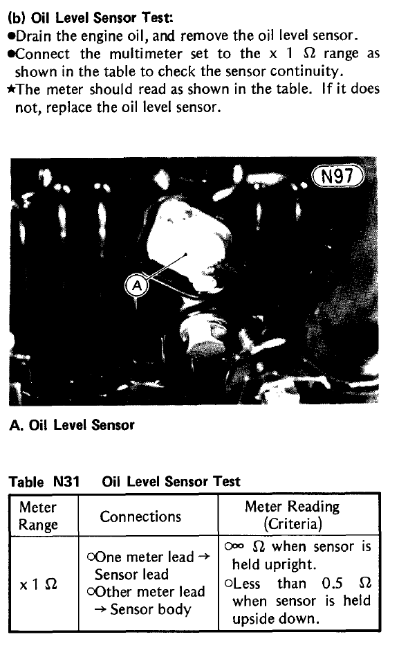

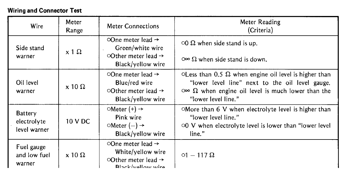

Here's a table from the KZ750 manual. It's in the 83 model supplement but I'm not sure if it applies to the spectre (only the H, L and ZX models are referred to specifically). If you have two leads going into the sensor you can test the resistance between them and make sure it is in range. If you only have one wire, you can probably test resistance between the wire and a clean spot on the oil pan (but I'm not sure you can go by the values in the table).

OK, I would assume that the warner unit detects the disconnected wire and grounds the light to turn it on. It may be a fault in the sensor. Someone should correct me if I'm wrong, but the oil level in the pan should drop slightly when you rev the bike. It may be that the sensor it just a bit off and thinks that the level is too low. You could test the resistance of the sensor but you need to remove it which would mean draining the oil again. There is a page describing how to test the sensor in the manual.

I can lay the bike on it’s side and remove the sensor. But I’ll be honest I’m not sure how to test it.

Just got done checking the sensor and it seems to be working correctly. When I have it right side up the volt meter shows nothing and doesn’t beep. Once I turn it upside down the volt meter starts reading and it beeps.
The reading shows a bunch of numbers then bottoms out at 0.00 Ohms. Which it’s supposed to do. So maybe my oil is still actually low. Idk I’m gonna buy some more oil and see if adding some helps.
