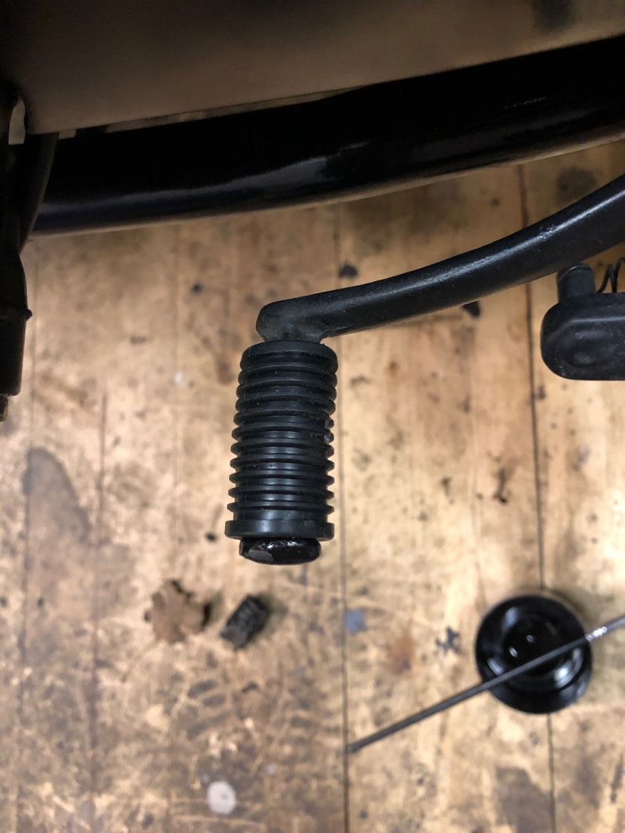

I’m planning to replace the rubber on the gear shifter, do you heat up the rubber before to push it on?

Yes, a little heat will soften the rubber.

Try heating it in hot water along with a little grease.

By heating the rubber with hot water, was it just like knife in butter! :)
