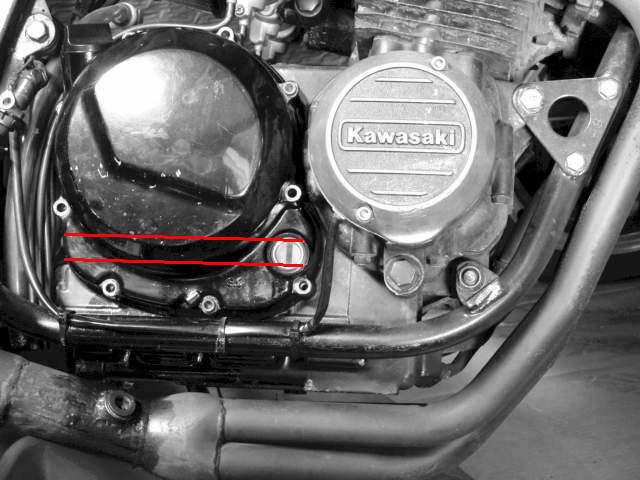

Have you checked the oil level? Whoever changed it could have put too much in, or you could have a carburetor malfunction that is filling the crankcase with gasoline.

That amount of oil may be correct, but that is not how one checks the oil level on a KZ650. Take a look at the right hand side of the engine near the bottom. There you will find a site glass in the side of the engine. With the engine on the centerstand the correct oil level is obtained when the oil is between the upper and lower marks next to that oil level window - preferably near the top mark. If the oil level is above the top mark it is too much. Ed

This photo is on a 550. I think the oil level window may look different on a 650, but basically in the same place. When the bike is vertical and level, there should be a little bubble of air at the top of the window.

The 550 looks the same as the 650 to me. In the pic below the bottom of the meniscus is just below the upper fill line.
