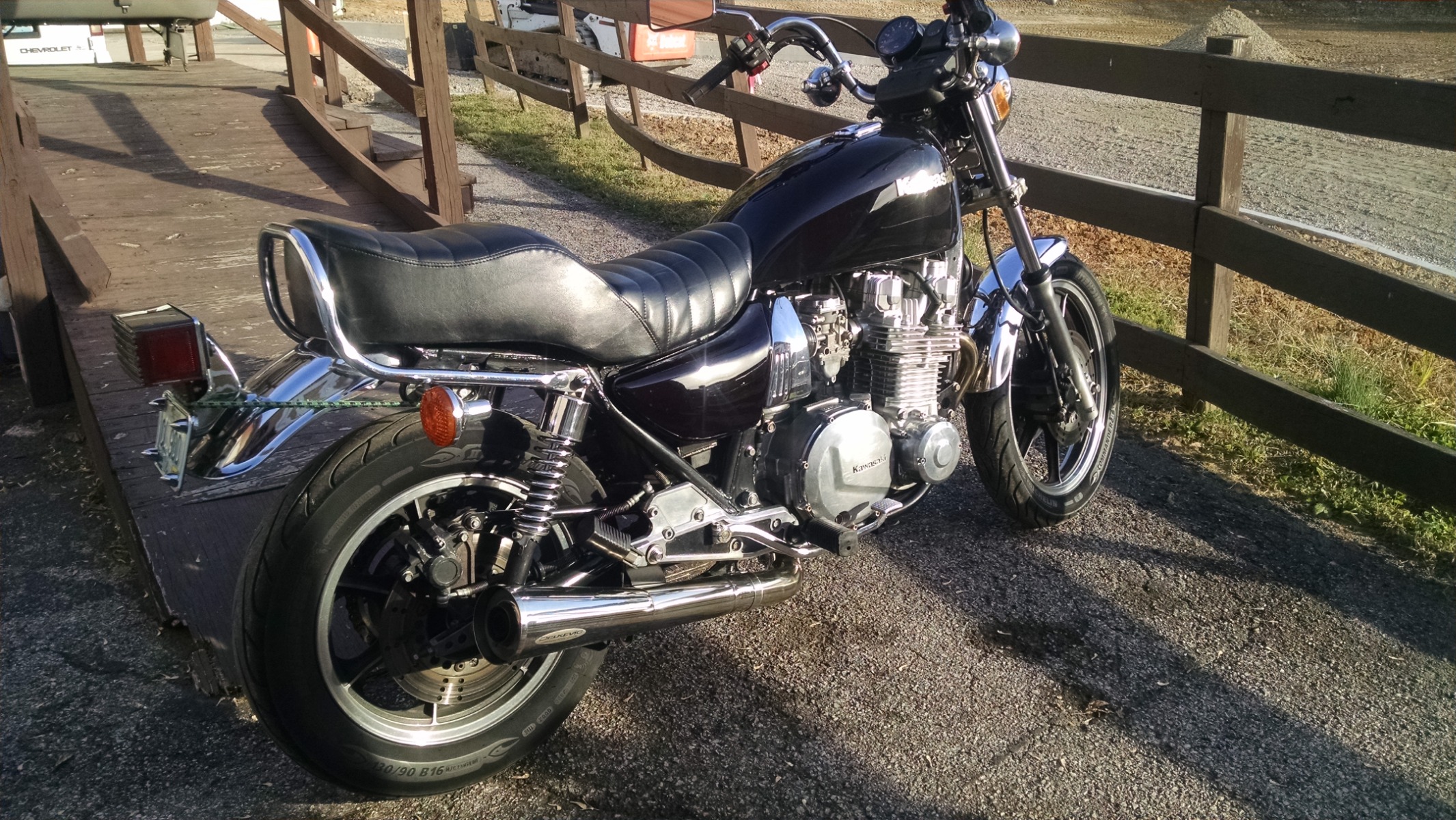

Re: Kz1000 feels slow
12 Mar 2020 08:01Good looking bike!
