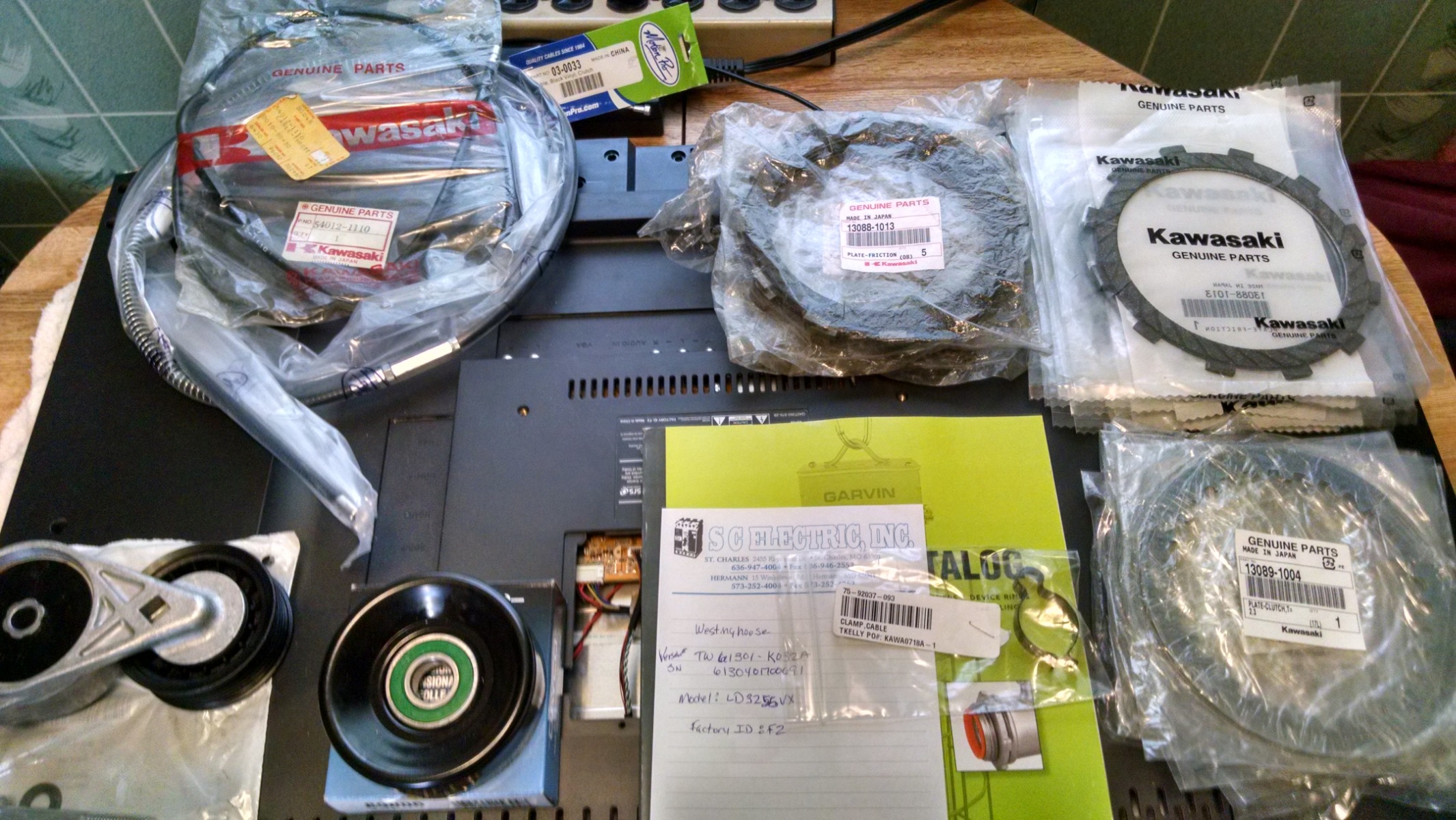

The 1100 J-engine has six 92081-1114 clutch, and twelve 92081-1115 clutch damper springs. They differ, and are not interchangeable. Part drawing link below.
www.cmsnl.com/kawasaki-kz1100a2-shaft-19...04.html#.Xm-C1Lh7mt8
I ordered a set of six Barnett clutch springs with the hope they will compensate for weakness in the damper hub springs. Am getting a little bounce in the clutch when moving from a dead stop. Despite that, the clutch works incredibly with the new fiber and steel clutch plates.
There's a new crisp and precise feeling when shifting gears that I will enjoy getting used to.
:woohoo:
:woohoo:
