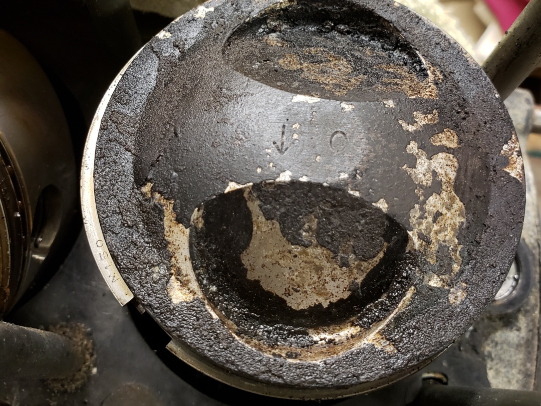

Dirty piton on engine. Note the dome which measure about 6.5mm or 1/4"

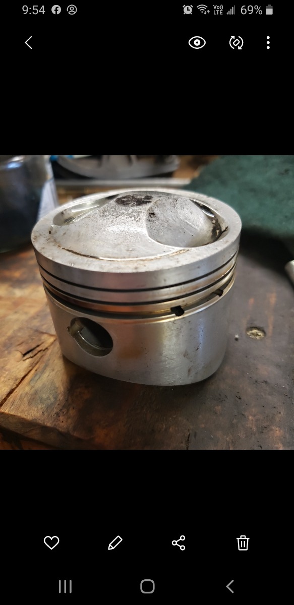

same piston after lots of cleaning...

You have an older Wiseco big bore KZ750 piston.

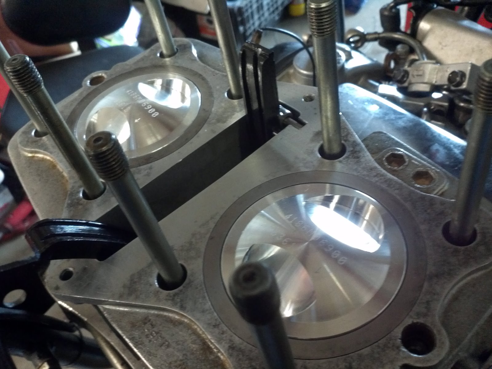

The newer pistons have the part number lazer etched into the top like this.

14 Feb 2020 19:05
If that is a āCā stamped on top, then you have, as others have noted, a vintage design of pistons Wiseco no longer makes. There may be a chance you will have to have custom rings made for these pistons as Wiseco no longer supplies them.

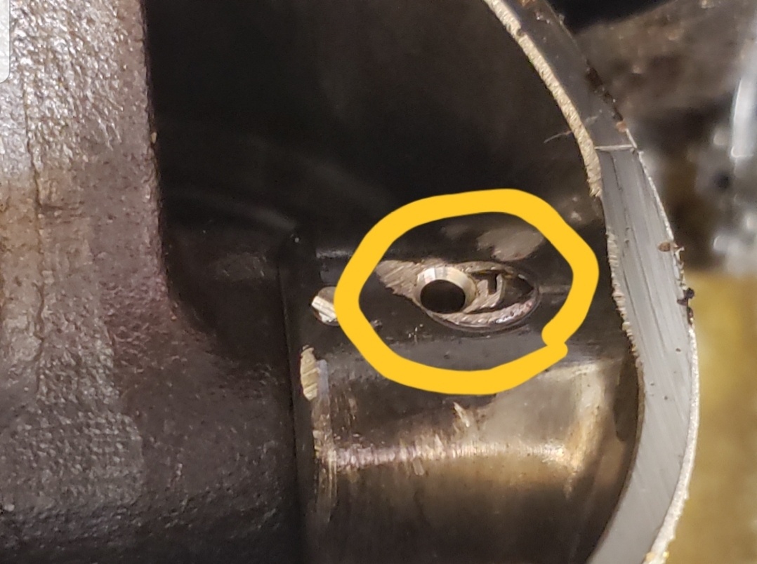

Thanks guys. I had read the linked topic on wiseco rings and along with the logo figured the pistons were definitely wiseco, but the lack of info on the part numbers had me confused. Does anyone know what compression ratios were offered in the old range? Only offerings now are the 10.25:1 and 8:1. The part numbers on my pistons are partially missing as the gudgeon pin oil hole has been drilled and debuted overtop of the numbers. The part number starts with a 4 and ends with a 3. See pic.
