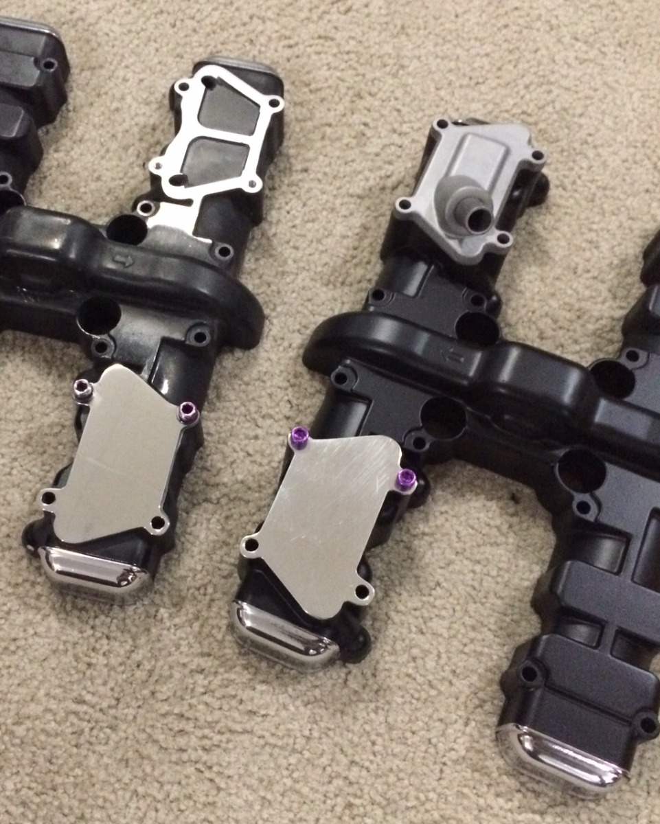

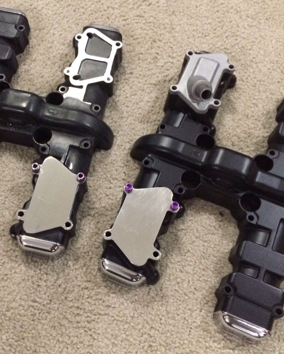

I am in process of doing a smog head. Does it matter if I plug on top? Or bottom in the valve combustion chamber?
I just use an 1/8" NPT plug up top of the cylinder head. I mill the ugly block off and bolt a flat plate on like the APE. I make my own flat pieces.
As long as you use the breather on the back end top of engine. No problem.

It shouldn't matter as long as air can't get into the exhaust port.
