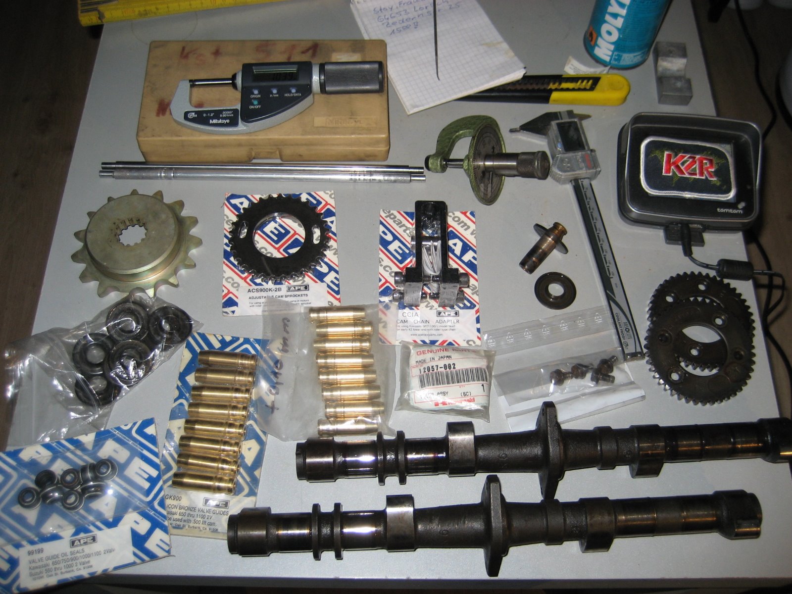

I would buy a good used set of GPZ1100UT (ZX1100A1) cams and APE cam sprockets.
Trust me you will hear and feel the diffrence.

The lope at idle are from high lift long duration cams. That requires porting, high compression pistons, stiffer valve springs, slotted cam sprockets, cam clearancing and larger carbs. Just dropping in high lift long duration cams won't work because you'll never be able to tune them to run correctly. Scirocco has the right idea but your not going to get the lopey idle.

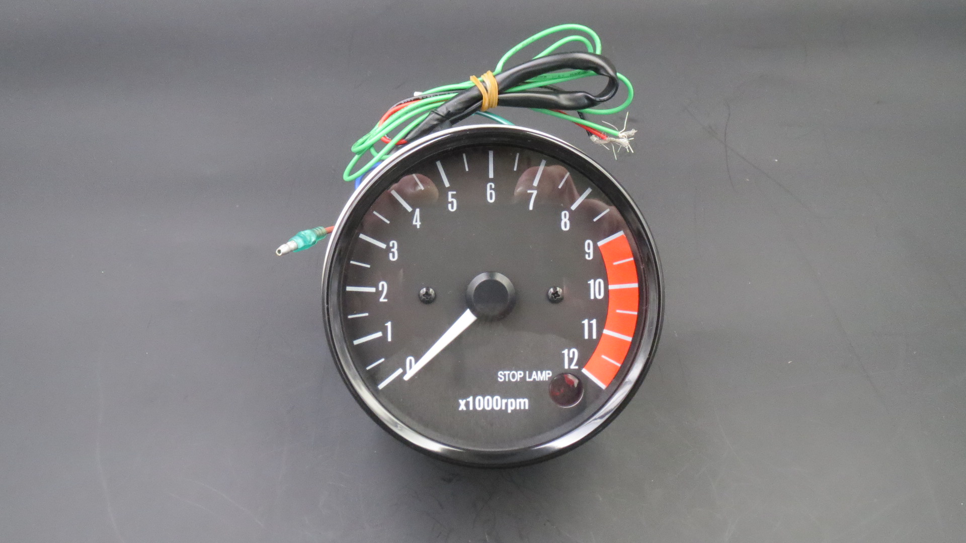

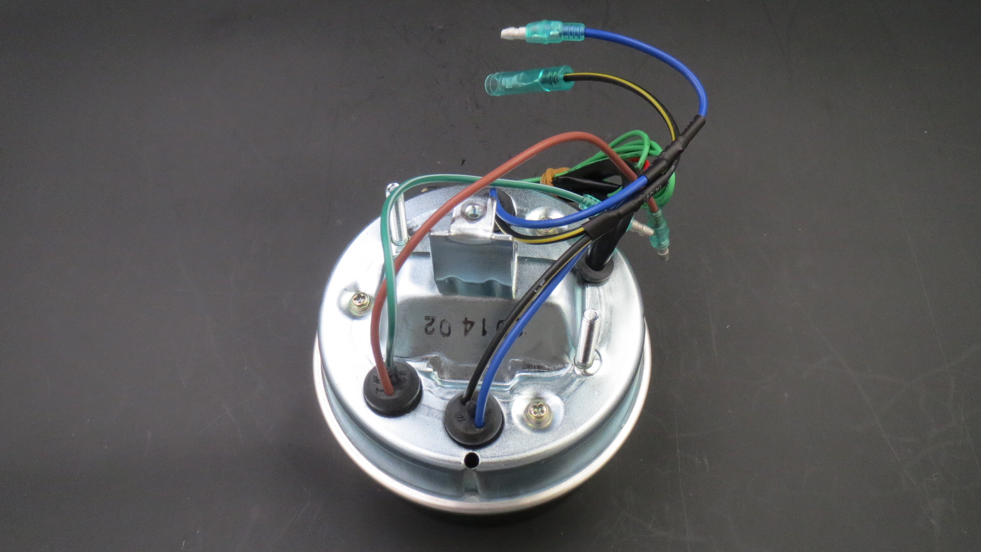

Do you loose the tach drive with all the GPZ cams?
Re: Cam question; recommendation?
29 Dec 2019 14:23

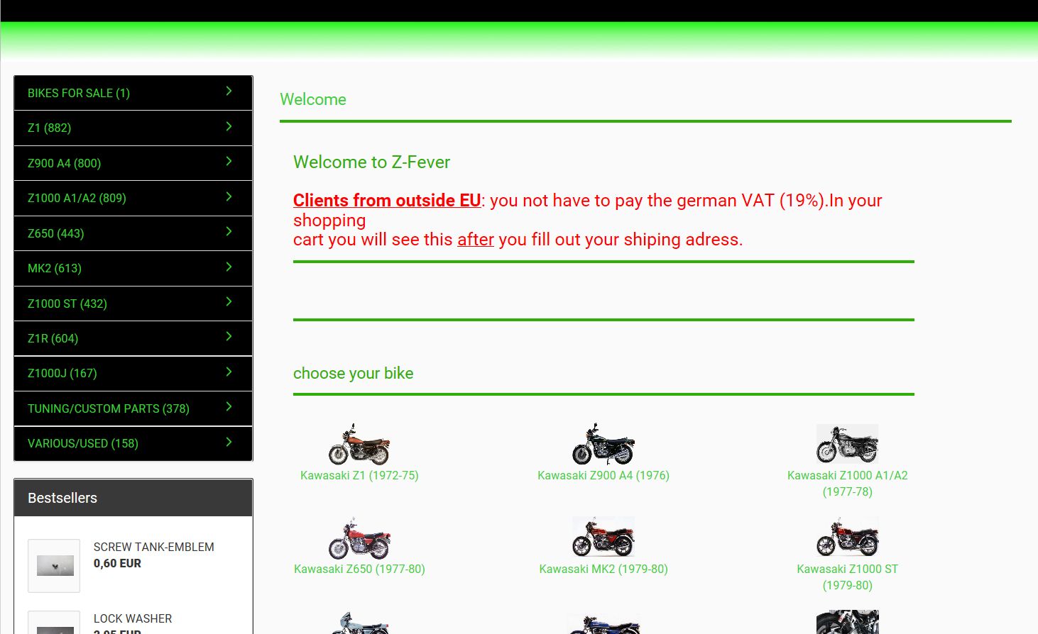

Where did you find that... I searched for days and came up empty... Jim at Redline sold them but told me they were no longer available... something about the factory that built them burned down.
29 Dec 2019 15:39 - 29 Dec 2019 15:43
z-fever.de/shop/en/?cat=c225_Amaturen---...ml&cPath=127_197_225
z-fever.de/shop/en/product_info.php?info...eter-electronic.html
Last edit: 29 Dec 2019 15:43 by Scirocco.
29 Dec 2019 16:23
Scirocco, thanks for the lead, I have parts coming from them for my ‘76kz900 front dual disc conversion. Delivery time is lengthy but worth it
