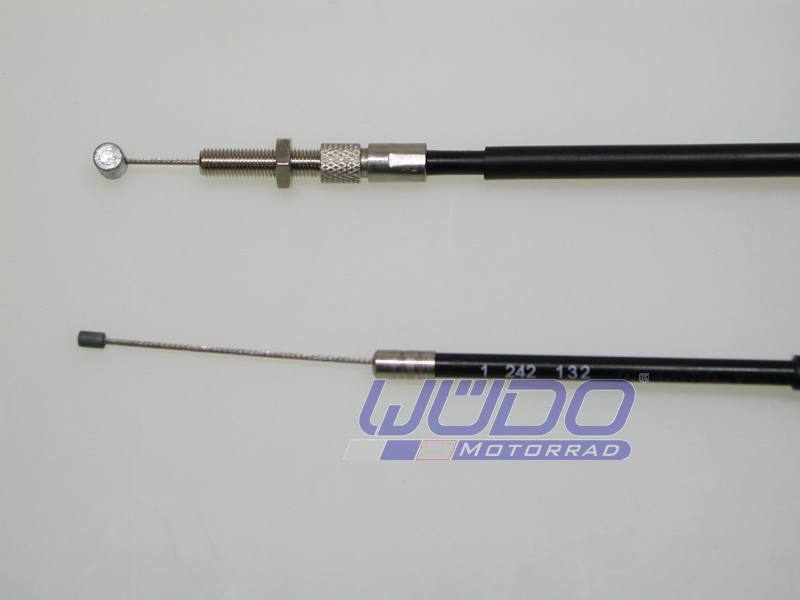

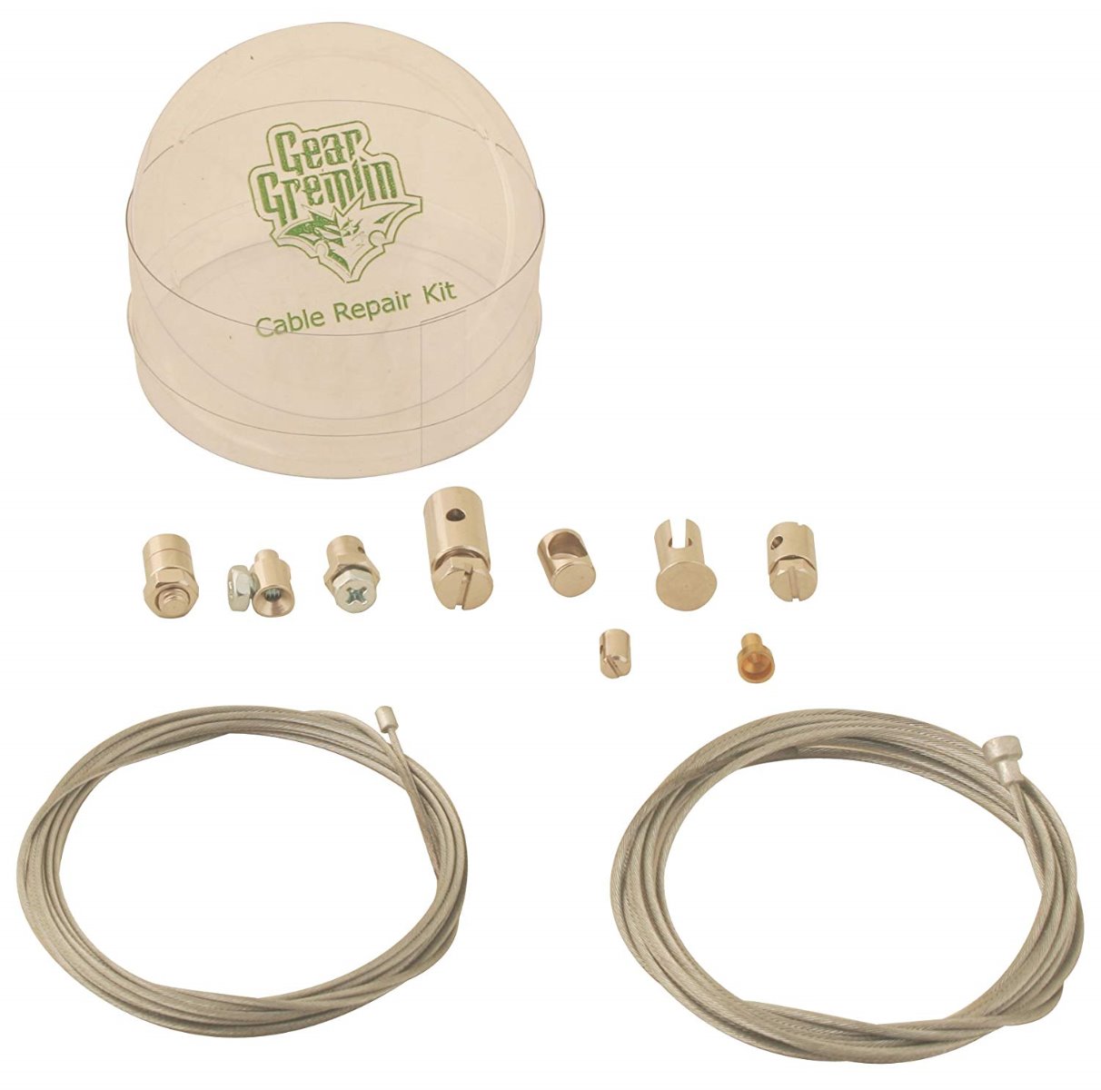

I appreciate everyone's input, alas I've run into another problem the carburetor I ordered will not work with my throttle cable, I ordered a knockoff Mikuni slide carburetor and it turns out the end of the cable is to big to fit in any of the slots, and even if it did work I don't think I have enough clearance for the throttle cable to fit properly under the gas tank without it binding up, I really cannot find a close enough carburetor that is on the cheap side that is set up similar to the stock Keihin cv32.

A Mikuni slide carburetor need a different smaller throttle cable end nipple. You can find a lot of DIY repair kits on evil bay and Amazon.
