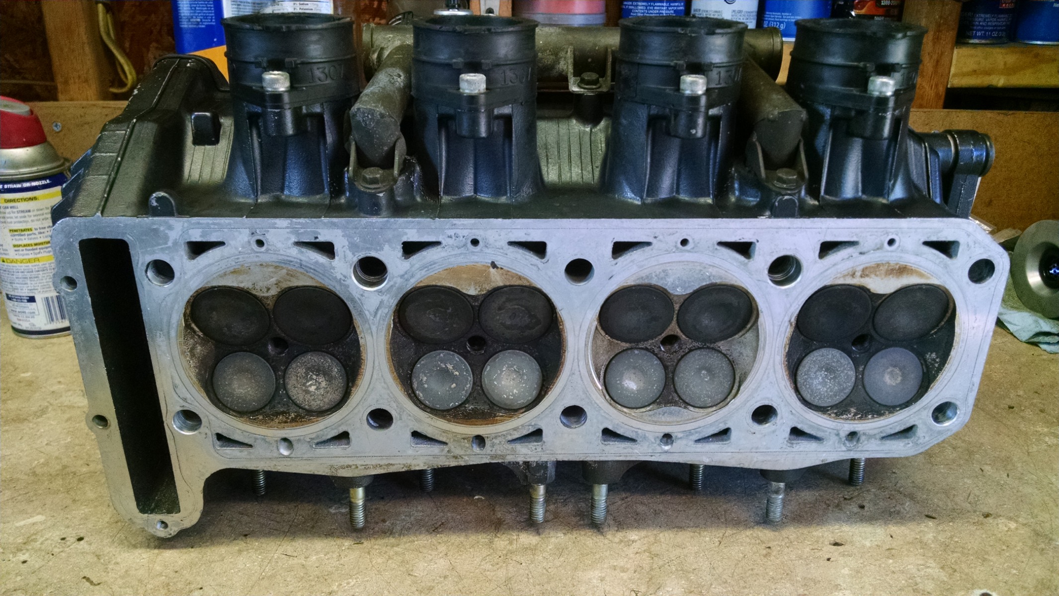

I'd remove the pistons and rings for a good cleaning at least. That carbon gets everywhere and can cause deep scratches in the bores.
I'd also go with new rings and a good hone.

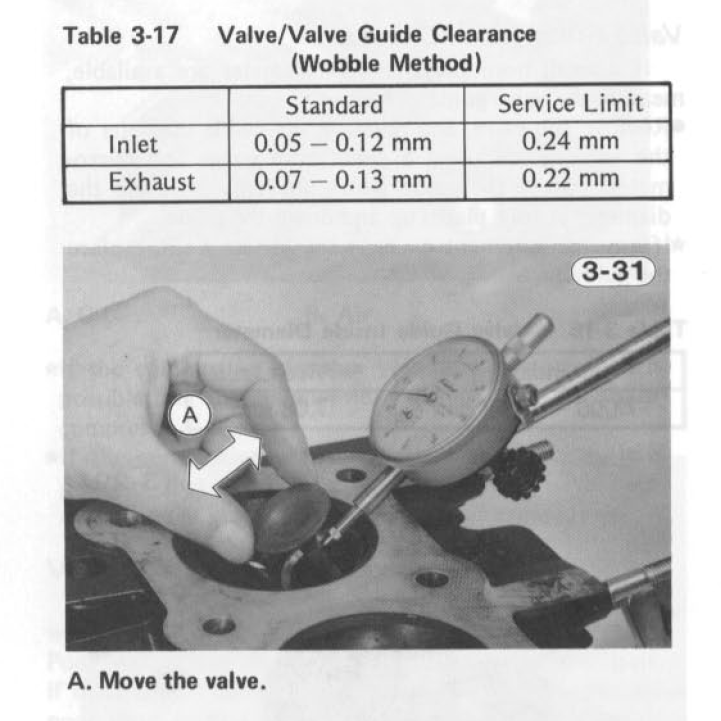

Some side play in the valves is normal. This is a snip from the factory 1000 manual showing how to test the play. Spec allows quite a bit of clearance.

I'm leaning towards new rings and a hone because I don't plan to go back into this engine ever again.
Yes, I have that valve spec but I don't have a dial gauge. Maybe I should buy a gauge....would be cheaper than replacing the guides and seals, except I've already ordered and paid for them.

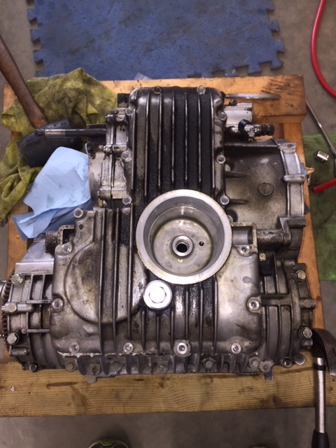

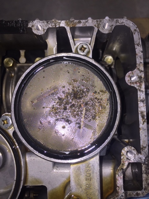

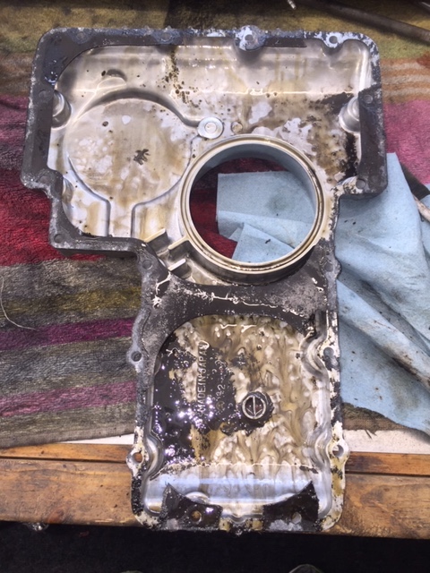

The engine is out of the frame. I started stripping it. The attached photos show what it looks like from the bottom. Not bad for 44 years!

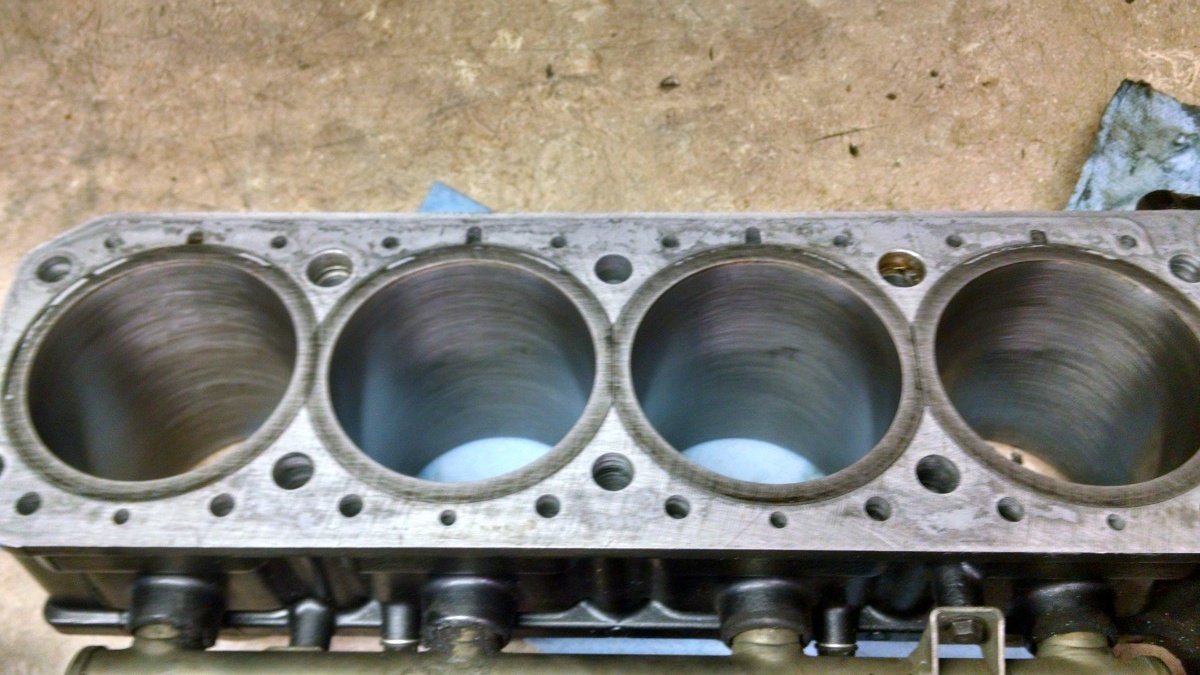

I did a light deglaze, these cast sleeve bores look great.
