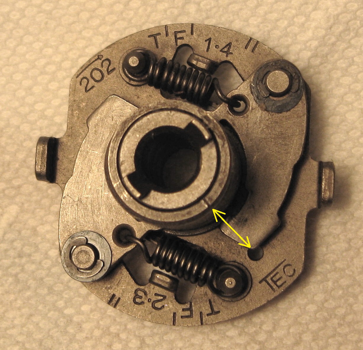

By any chance has the points cam been removed for cleaning or some other reason since the bike last started? If so, it may have been installed 180 degrees off in which case the bike will not start.
The image below shows the KZ650 points cam in the proper orientation; yours probably has similar marks. Ed

I have not removed this thank you I did not know about the marks
Thanks
